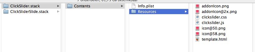

I only have 2 folders with the .stack extension.
I can not double-click the folder, it just opens and shows its contents.
Dragging the folders or its contents does not install onto RW.
I looked for a “Stacks” folder, but could not find one.
If I look from my Mac via the network into my wife’s iMac, my Mac “sees” them as folders, while they are in fact on her iMac as installers. Somehow my Mac sees those 2 installer files as folders. Not sure why.
I’ll post a screenshot of what I see on my Mac below.
Thanks again to you both for your kind help. Hope you can solve this for me.

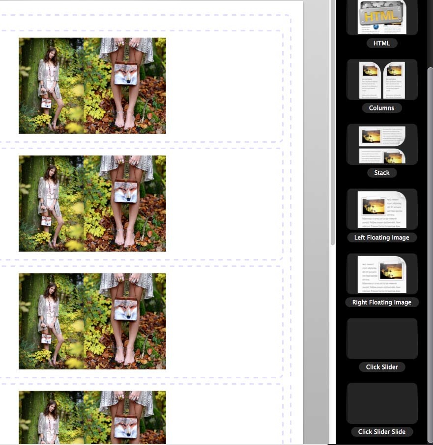

Thanks Zeebe. In the mean time I upgrade to RW 5.3.2 and presto: the installers were visible! I installed the 2 stacks and got the confirmation that they were installed OK. However: they appear like black icons in RW!!! Seems to me that is not good? Anybody recognize this? In the mean time I have written to Michael David for help on this as I can’t see a slide show yet, just 6 pictures in a vertical row… See photo attached…
Wow, so you are in stacks 1. Maybe the stacks do not work in Stacks 1, I would contact Yourhead and see if you can at least upgrade to Stacks 2 http://yourhead.com/support
Thanks Zeebe. Turns out I was working in an old Stacks version as you said. I will upgrade to Stacks 2 as you suggested. It seems my problems are over [fingers crossed] as the trial version of Stacks 2 shows the way it is supposed to be.
