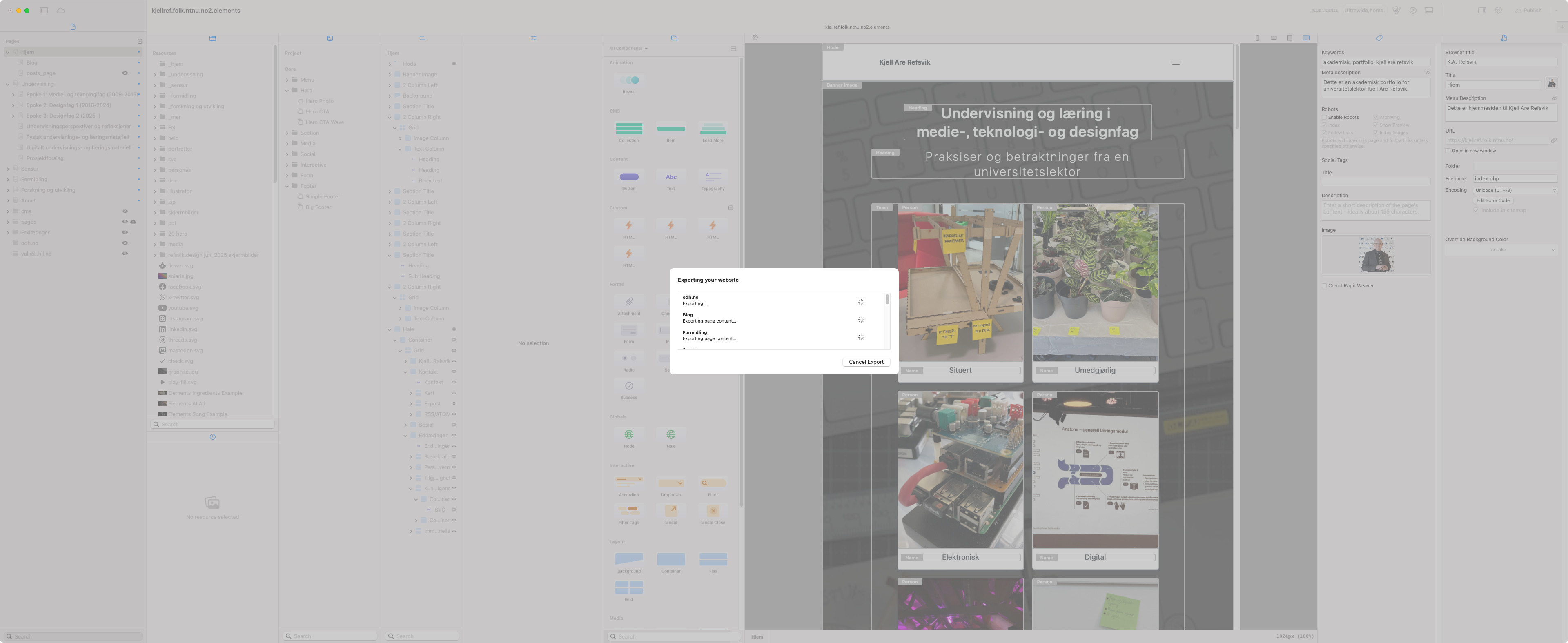

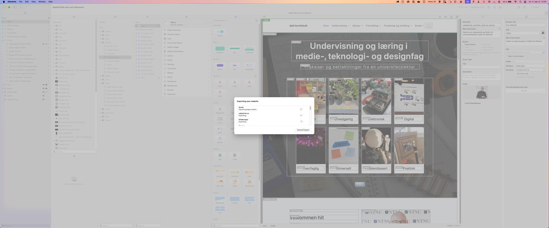

I’ve tried publishing while viewing the pages shown in your screenshots and haven’t been able to reproduce the issue yet.
When you have the “posts_page” page selected and publish, I can see in the screenshot that you have an empty export progress window. Are you always able to reproduce this, and what happens if you leave it for a while, does it eventually move on?
Also, do you store the project on iCloud or elsewhere on your Mac?

Hi Tom. Thank you for looking through my project. It never did strike me as particularly large, but I guess you could say that it is, at 6067 files in total.
The publishing issue is not showing up here either this morning. There is however a difference in the time it takes to display information in the publishing dialogue. When standing on the home page, publishing information shows up immediately. But when standing in my posts-page or any other page, it takes a bit of time. That may have been the problem all along. Me not waiting enough for information to show up, being used to its immediate appearance usually? And that the size of the site has something to do with the lag?
I store the project locally on my ssd drive on my MacBook Pro M3 all the time. Should not be a storage or hardware-related reason here.

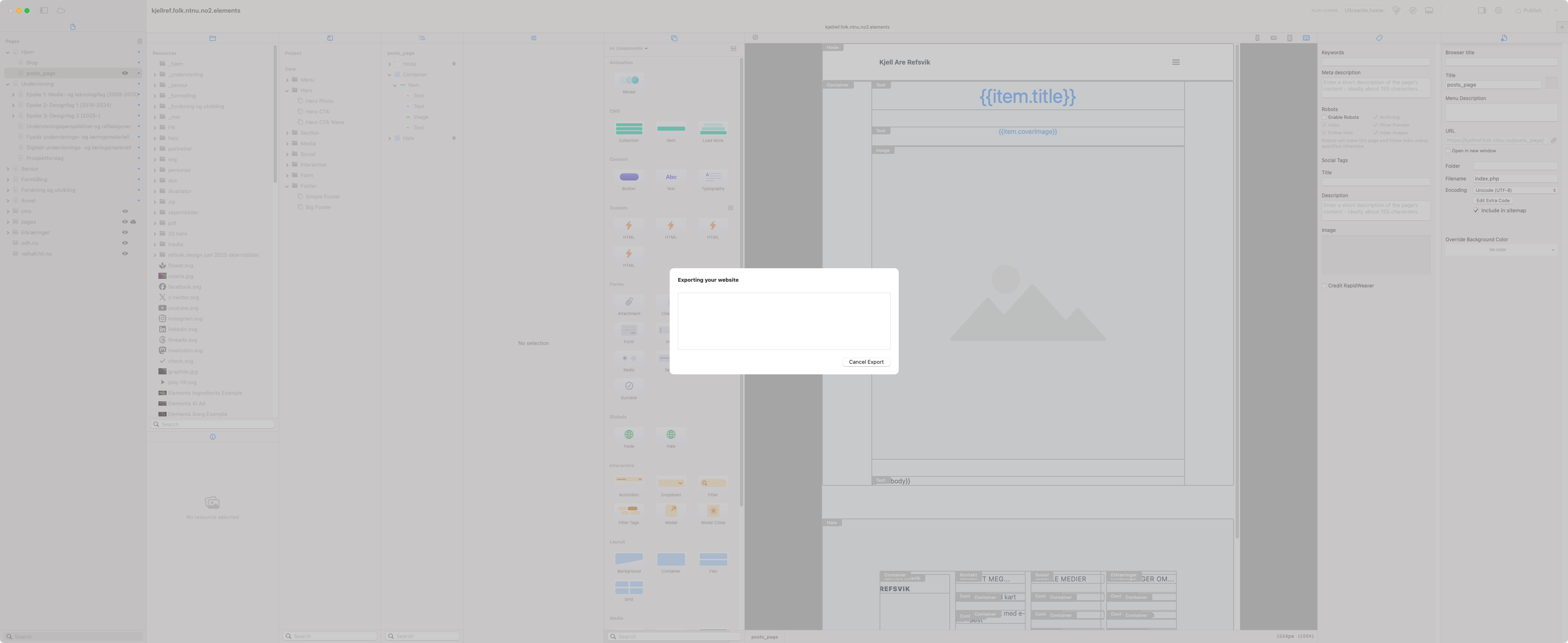

An update here @tpbradley . Created two new pages today, and this happened when pressing publish:
I aborted this empty window after around 60 seconds.
When making the homepage the active page, publishing goes through immediately.
