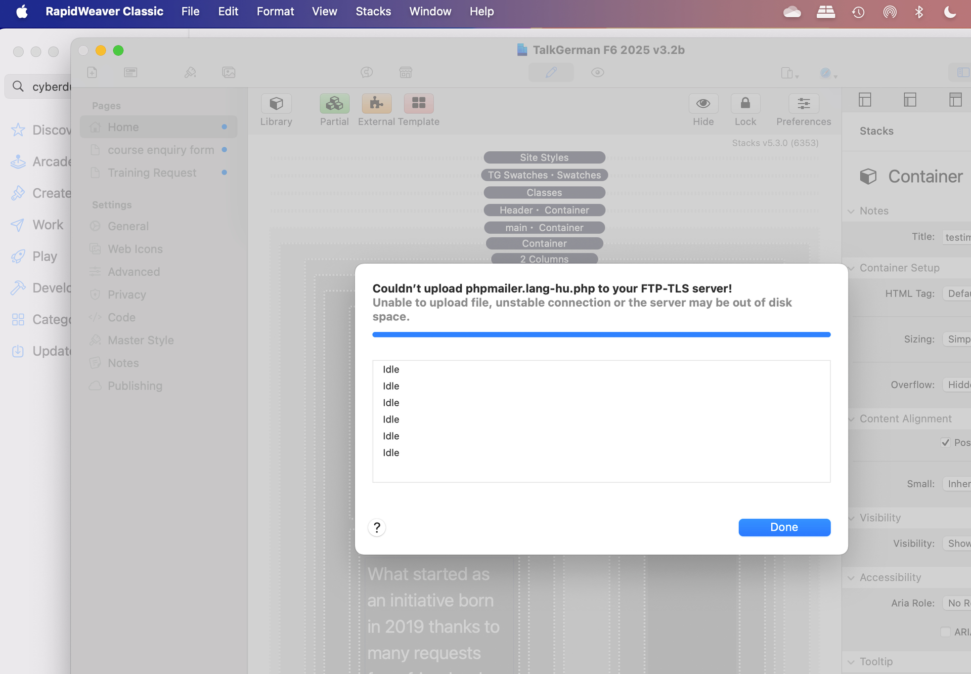

Today I updated to Classic 9.6 and am not able to use the FTP functionality, it gives a weird error message that I have not see before since I started using Rapidweaver since almost 9 years ago. Please see the screenshot.
I have tried different connections and all give the same error, I finally had to use FileZilla that did work and without ANY error during the transfer!
I look forward to advice!

thanks for this, I have tried but not working, the only thing that currently works is FTP in combination with extended passive, active doesn’t work in both modes.
I seen the issue is more discussed around Elements and not 9.6 Classic, are there any further settings I could think of? I do prefer to use publishing in FTPS mode.
Can you try SFTP?
Yes I have and it gives another error…also I noticed when publishing starting up I see "forcibly reset messages first and continues to show uploading for just a moment and followed by the error message…

HI @dan the error message is in the screenshot, "couldn’t upload… to your FTP-TLS server!etc.
