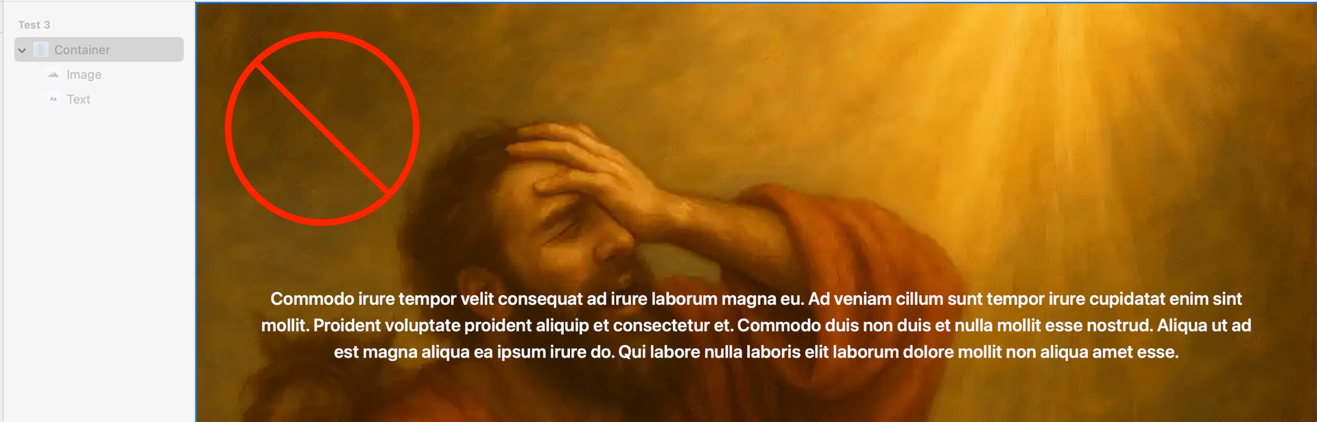

Here I used a container with a background image. I placed an image using a transparent png file and a text component. Is that what you are trying to do?

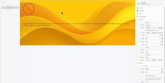

Did you play with z-index?
not sure what your final design is to be
Elements has multiple options, extreme options
I started to try and show different ways of doing this, too many, if I have read your ask right, these may or not meet your need, there are many other ways
These options do not use margins or padding to position, didn’t get into that
project here
elementsapp://downloadDocument/EpdjnLKYfwQn
Steve is correct, there are a number of ways to do this. Below is what I did showing the settings for each of the 3 components.
