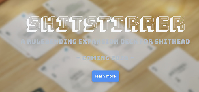

The actual site’s at https://www.shitstirrer.com (apologies for the s-word, but… you’ll understand when you see it :sweat_smile: :grimacing: ), if that’s any use for you. It’s WIP (but nearly there for a first pass) at the mo.
Thanks!
Not trying to stir it!:joy::joy: I find your text near impossible to read just to help you on your quest. The flip card works OK on iPad!
Ah thank you – I guess that must be a dark mode / light mode thing. Hadn’t really realised I’d need to look into it as it’s only appeared the other way around (with nice readable dark text) my end. I’ll get it sorted tomorrow!
Thanks for the heads-up!
