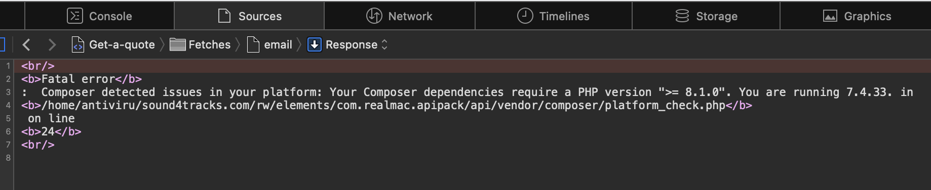

When filling out the form I get the below error. A PHP update is required.
The Form Component requires PHP 8.x or newer, so it sounds like you need to upgrade it on your server. You can sometimes do this via the admin panel on your host, if not, drop them an email and ask for them to update it for you.
Once this is done, you should be back up and running!
It works like a charm:)
