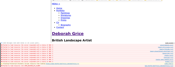

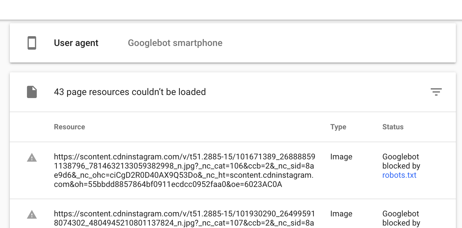

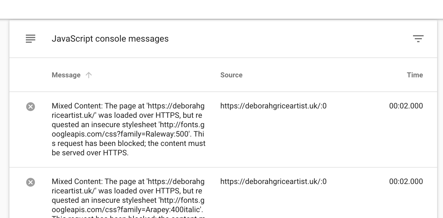

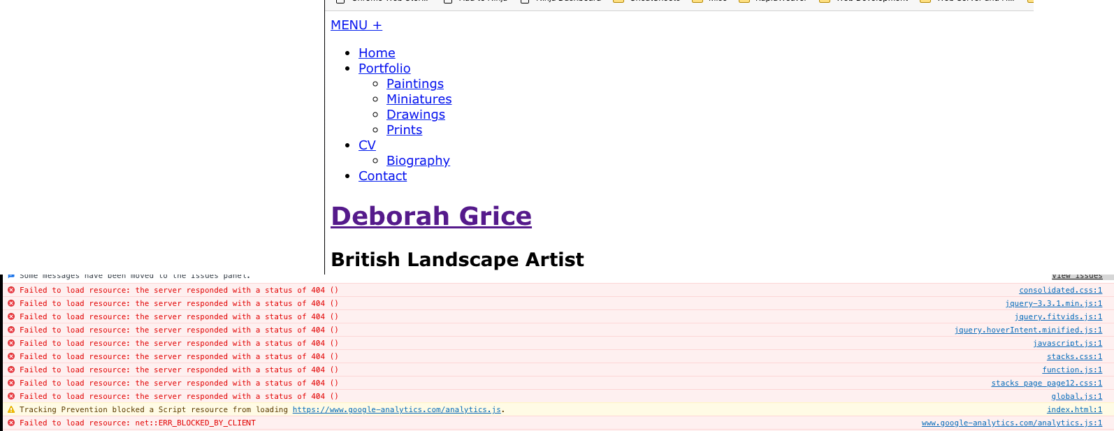

@teefers Please can I ask you what is going on here? I’ve not had this warning before…it’s from the google search console. I have an instagram connect plugin, looks like it’s creating issues. Not sure about the other problem.
I think and someone with more knowledge may give you a better answer but the top picture about instagram is google following one of your links which takes it to the instagram servers at which point the instagram server has a robots.txt file telling google that you cannot index the content any further.
The second picture is a reference to a font on your website is using https instead of https to get the font and google is telling you that all content to be referenced should be over https. How your find where that font reference is will be the part I cannot help you with.

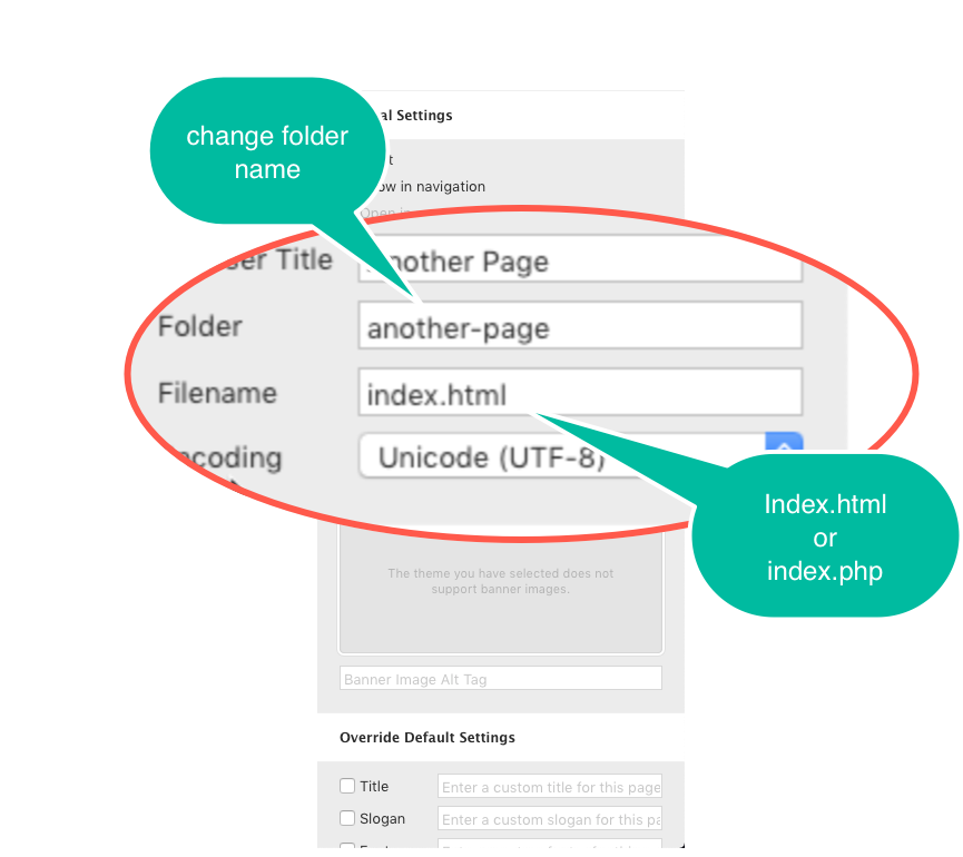

I do have the tidy link box ticked thoguh, but it doesn’t work for me…? Here’s a screen shot…
When you use tidy links you should leave the file name set to index.html. you only change the folder name:
So each page is in a folder of it’s own and the so you don’t need the index.html as part of the URL.
With tidy links you would use a URL like this:
https://deborahgriceartist.uk/painting/paintings/
and that would actually open the page:
https://deborahgriceartist.uk/painting/paintings/index.html
The shorter URL makes it easier for users to read and can help with seach engines.
