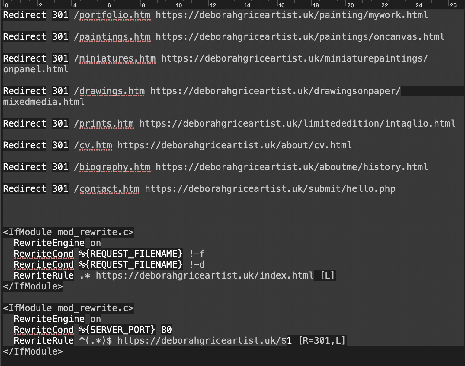

I have also attached a grab of the redirect .htaccess file which shows that I sent a redirect on the 8th.
The current .htaccess file is as above, should the redirect code still be in there? Did I do it correctly?

Hi @teefers @Pyrobrit, This is my update .htaccess file. Does it look please? Thanks, Debbie

The screenshot of the htaccess alone isn’t enough information.
I do see what I think are issues. But to give you a proper answer I’ll need more information.
For example, you have a redirect to a 404 error document, any the next line down you set the 404 page to the document that you just redirected away from?
You have a general redirect (everything) to https://deborahgriceartist.UK/, not sure what that rule is doing here (I’m assuming this screenshot is from that website).
It would be a lot easier if you could tell me what you want to redirect from where.

As a rule, I don’t like to comment on htaccess files unless I can see the entire file. The reason for this is something “upstream” on the file can affect what’s happening “downstream”, and you can easily get yourself into a loop.
It’s difficult to read screenshots unless it’s only a couple of lines of code.
So if you would like my input (I’m happy to provide) then please feel free to copy and paste the content here on a post. Just make sure you have a couple of blank lines paste the code in and select the code and hit the pre-formatted text button above where you type. </>

For example in some of what you have in your last screenshots, you have two <IfModule mod_rewrite.c> blocks. The only reason to have a <IfModule mod_rewrite.c> block is to allow Apache to skip processing a section of directives if it’s not currently processing that module. You don’t usually even need one block, but if you want those two blocks should have been combined.
