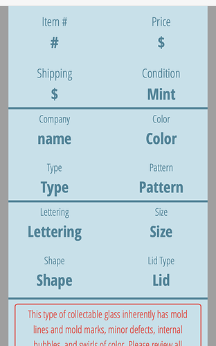

Any suggestions how I could make the upper section of this a Global, and it needs to be responsive? The entry fields are the fields with bold text above the red text disclaimer. Elements has Globals and Templates (now). I think the better solution would be Globals with editable fields, and that would solve my problem. I think RW Stacks has that function.

No. I would enter the text in the Elements page which will be different for each piece of collectible glass I sell.

This is what it looks like mobile:

It’s easy if it did not need to change the layout for mobile. I fear it’s too complex to do that.
would you not make the upper layout a global and override each text field you need to edit within that layout

@upssjw Thanks. I did not know what Global Overrides meant before, I do now! That is exactly what I want.
