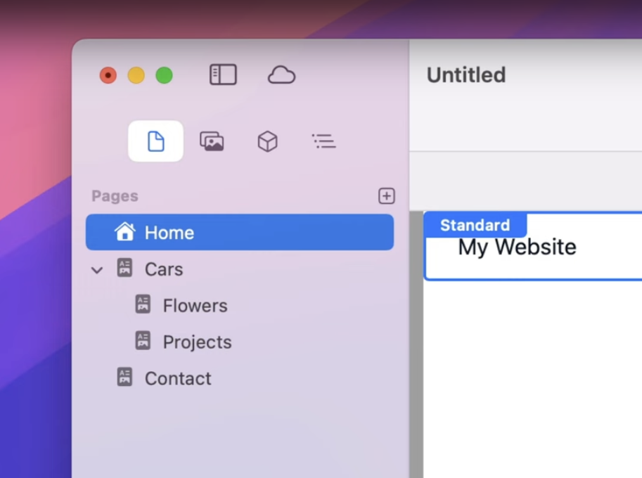

But I should have noticed the strange URLs and screenshots posted by others showing how they have organised their content.
@dan did put out a video about this earlier, but did not go into great depths about the issue of organising a site. He did not go into a deeper explanation about why you would create this site layout, versus using folders. Maybe where should be a video going even deeper into this topic?
Here is my structure, changed to using folders:
I found myself wanting to have a summery page at the top of each folder, showing a summary of what goes on inside as each folder contains sever files and sub-folders.
