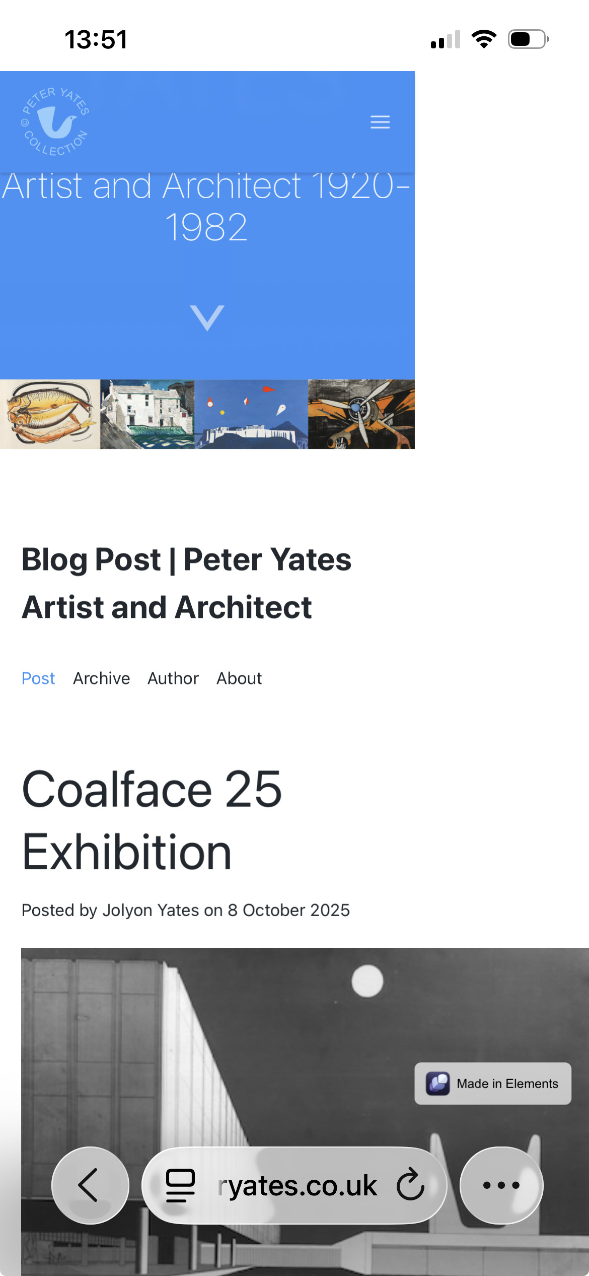

I think I’m understanding that markdown isn’t going to give me responsive images and this is throwing my formatting out when viewed on my iPhone. example here
so I’m looking for a solution

my iPhone, looks like your image is wider than the page? or that screen size only, image is pixels?
@jbob you’re setting a pixel width on some of your images. When you do this it forces the image to be that width, even if the screen size is smaller. This is why you’re getting issues.
I’d recommend never setting a pixel value on images, not if you want your site to be responsive and just work on all screen sizes. You’re better off seeing it to “Auto” or setting a % value.

I’ve tried assigning no size to the primary image on the blog and on the post page
It doesn’t help
On my (iPhone 13) - the header makes it most the way across the screen and the lower image goes off page to the right
I’m prolly doing something else that’s stoopid ?

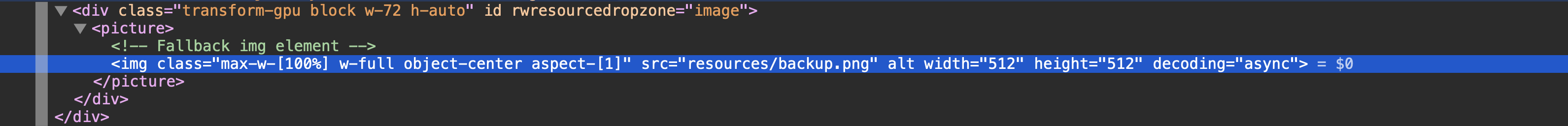

not sure if this helps
Think you’re onto something Steve !!
Tailwind units are 4px - so padding 5 = 20px, both sides = 40px, image in pixels plus padding = ?
more than the width of the screen?, this is without responsive control
eg padding 40px + 400px (image) = 440px
you can set different % for each screen size as well
