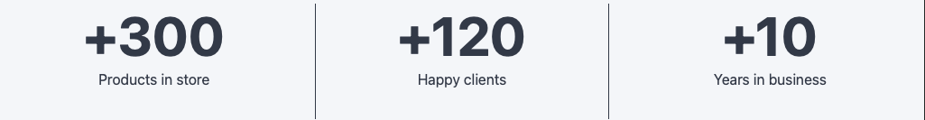

I need your help, there is one thing which drives me regularly crazy in Elements. It is vertical centering.

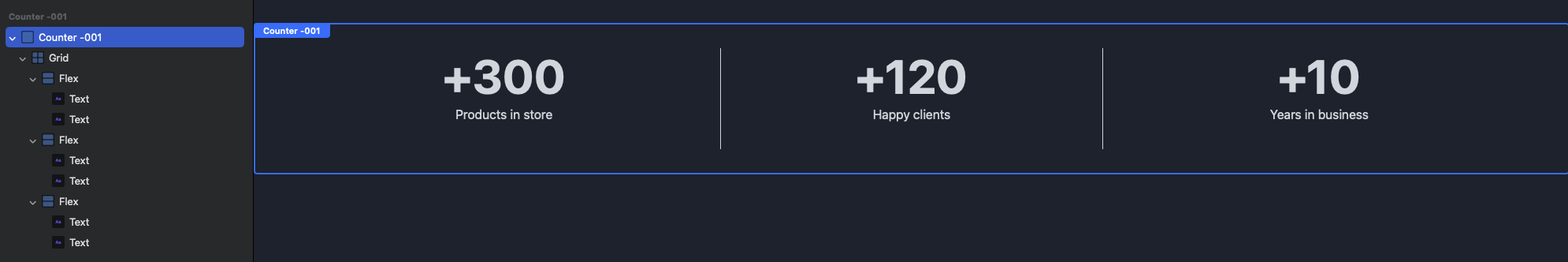

I currently have the case below. It is a grid with flex boxes inside and then 2 lines of text in the flex. No matter what what I do the text always sticks on the top and does not get centered in the grid. My expectation was, that using the “align” or “justify” of the flex should do the job, but they don’t.
Guess I have a lack of knowledge here, so any ideas how to best center text in a flex?
If somebody want to have a look at the file it is here:
elementsapp://downloadDocument/8jsEClB1zUTt
I think the problem is caused by the bottom margin of each of the labels. If you set that to to 0, you should be able to set the Justify Content of each flex to Center.
Thanks @tgr that exactly was the problem :+1:
I was sitting minimum half an hour in front of the screen and didn’t see it :slightly_smiling_face:. Thanks man!
