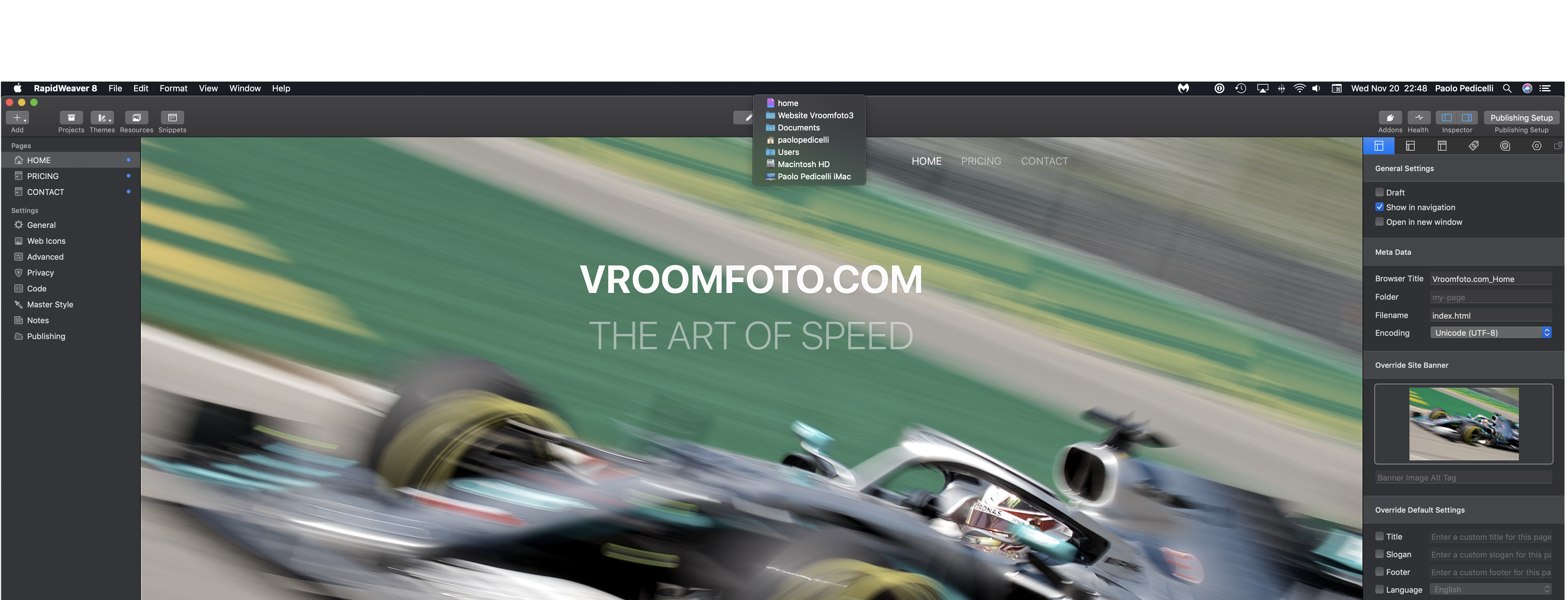

That shows you were your RW project file is stored. When you’ve competed your site you will publish it to a web server.
The first pane in the right-hand inspector has all the the settings that control the folder and file names used when RW generates the actual HTML files (via publishing or export). The current, best practices are to name the folder to indicate what is on it. Leave the filename as index.html.
You should keep all of your pages in the same RW project file. This will allow you to better manage your site navigation.
You could use Offsite pages to link to your external gallery pages, if you want them in your menu. If you just want to link to them from a text or image link, then you don’t need to. However, you should probably consider using Stacks and a gallery stack that can read your images from a folder on your web server. This will allow you to have consistent navigation on those pages too.

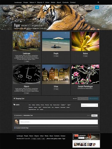

The app I use is jAlbum. My older galleries use flash, but the “skin” I plan to use going forward will be responsive for all devices and screen sizes and based on javascript I believe. And yes I’m planning to rebuild all my galleries from 2004 to today, however each event will consist of a single gallery as opposed to how they are now with multiple per race/event. Here’s a link:
All of that could be built with RW…
we can talk about that…and it would be much simpler.

And also, could you have a look above at my screenshots and tell me if I’ve set up/saved my site correctly?
Gve me a few mins
I would say no, you didn’t. RW is a website builder not an HTML editor. You will want to keep all of your pages in one RW project file. I roughly outlined your site in a blank project. Here’s a few screenshots:
With the way the folders are named, your home page will be:
http://www.vroomfoto.com/
Your main gallery page will be at:
http://www.vroomfoto.com/galleries
Your Formula 1 page will be at:
http://www.vroomfoto.com/galleries/formula1
That creates a nice site structure. It helps search engine understand the layout of your website, which helps SEO.
Wow, how’d you do that so quickly?? Lol, somehow it looks like the two pages I created are two separate projects then…somehow. So is there a way for me to restructure it correctly, or I need to restart again? And when RW prompts me to save the project, I can creat a file named Vroomfoto3, for example? And from my understanding, then RW will hold all the pages/elements…of my whole site in one file/project?
Well, there’s no contention those pages yet! I just added a few pages and set the page name and the browser title and folder on a few. And, the titles I copied from your existing site.
Yes, for most uses you have one RW project file for each website, not for each web page. Start by entering the General settings which are about your website. Then begin adding pages and setting the info on the right for each.
Yes, just open both your existing projects in RW and drag and drop one page into the other project.
Yes, you can name the project Vroomfoto3 when you save (or save as) it.
