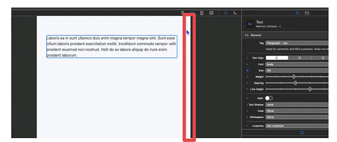

I think this is a known problem and is due to having a vertical scrollbar on the edit window? :thinking:
If you click on a screen size icon (e.g. MD) and then drag the edit window slightly to the right the font size will change from what you specified in SM to what you specified in MD.
Even though you click on one of the screen size icons to select the size, Elements is taking the size from the edit window width minus the width of the scroll bar and therefore using the next size down to determine the font size, if that makes sense.
It has caught me out quite a few times and is definitely not intuitive.

Great summary from @logrunner — and you’re absolutely right, this has caught a few users out!
This is related to how Elements calculates the active breakpoint for the canvas preview. When there’s a vertical scrollbar, the actual visible width is a bit less than the breakpoint icon you’ve selected. That means you’re sometimes seeing the styles for the next size down rather than the one you’ve picked, which makes overrides appear to “move up a step.” Dragging the window to resize (or hiding the UI panel for more width) will often make the preview “snap” to the correct breakpoint, showing your changes as expected.
What you’re experiencing is not the intended behaviour—and the Elements team is aware. It’s already on the radar to be improved for a more intuitive breakpoint/preview experience (after all, what you see should always be what you get in a true WYSIWYG editor!).

Not a fix, but this issue is caused by the always visible scrollbar (not that I can reproduce it here even when I switch to always having scrollbars visible).

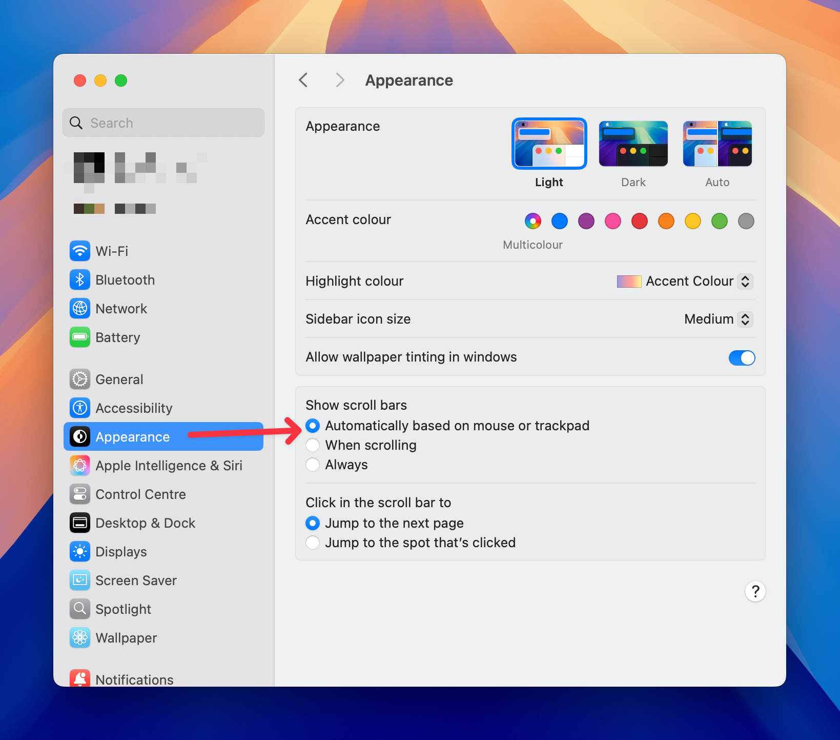

I’m wondering if this is related to the mouse you have connected/settings in the system. @logrunner, @jbyfield can you let us know the following:
  1. What pointing device(s) do you have connected? Is it a non-Apple mouse with a physical scroll-wheel?
  2. What are your settings in the System Preferences > Appearance > Show scrollbars?
My mouse is a Logitech MX master 3 - it has a physical scroll wheel.
My settings:
If I change the setting to ‘When scrolling’ - Elements works correctly.
@logrunner does this happen on all projects?
For now, just set it to “When Scrolling” to work around the issue.
UPDATE: We’ve managed to re-create it here, and we’ll look into getting it fixed as soon as possible!
I’m on 1.0.5 running on a Macbook with Sequoia 15.5.
I am doing the work on a Dell screen that somehow got forgotten about and stayed in my house after lockdown, set at 1920 x 1080.
Got a wireless Logitech M331 mouse with scroll wheel. It’s a red one so super fast.
Under System Preferences > Appearance > Show scrollbars I have ‘Automatically based on mouse or trackpad’ selected.
Like Jon, if I switch it to ‘When scrolling’ the expected behaviour appears so I will keep it like that.
