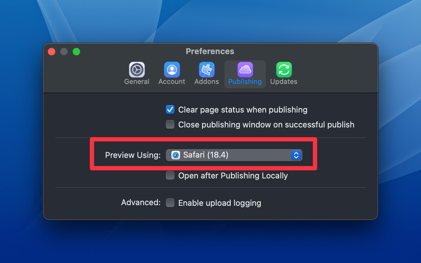

Doesn’t sound like a project issue… it sounds like Elements can’t find the browser.
Can you make sure a browser is selected in the settings:
I also think it might be worth restarting your Mac to see if that fixes the issue for you!
Done that already and Safari is selected. Preview worked when I was working on the first templates, but suddenly stopped working.
