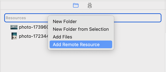

how would you actually use a remote image? In the Resource of an image there is only a “Choose” available.

You can add a remote resource by right-clicking on the Resources panel and choosing “Add Remote Resource”. You can then enter a URL to an image.
Once the remote resource is in your Resources you can use it as you would any other resources.
Note: this image is not managed by Elements, so you can’t do things like resize the image from within Elements.
