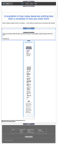

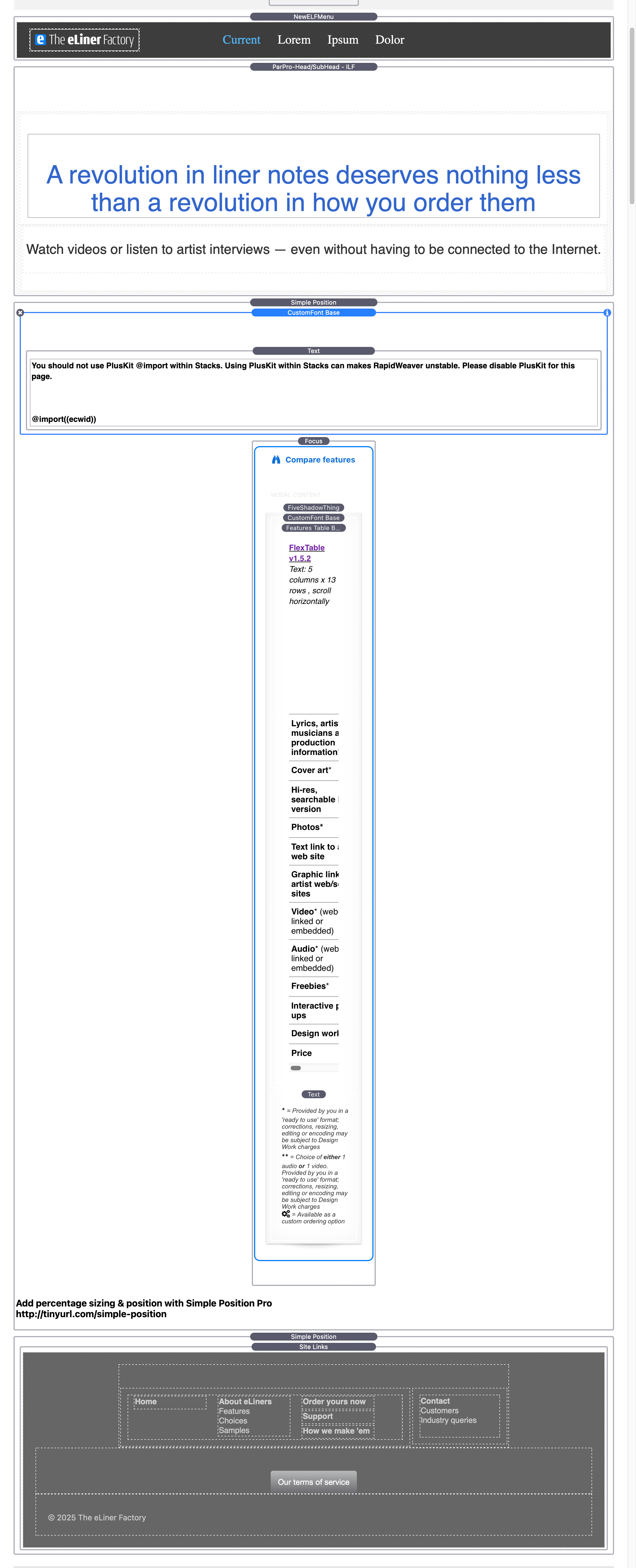

For your reference, here is a link to the live store page. And here is a screen shot of the page in RWC:

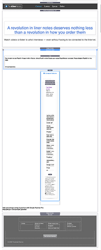

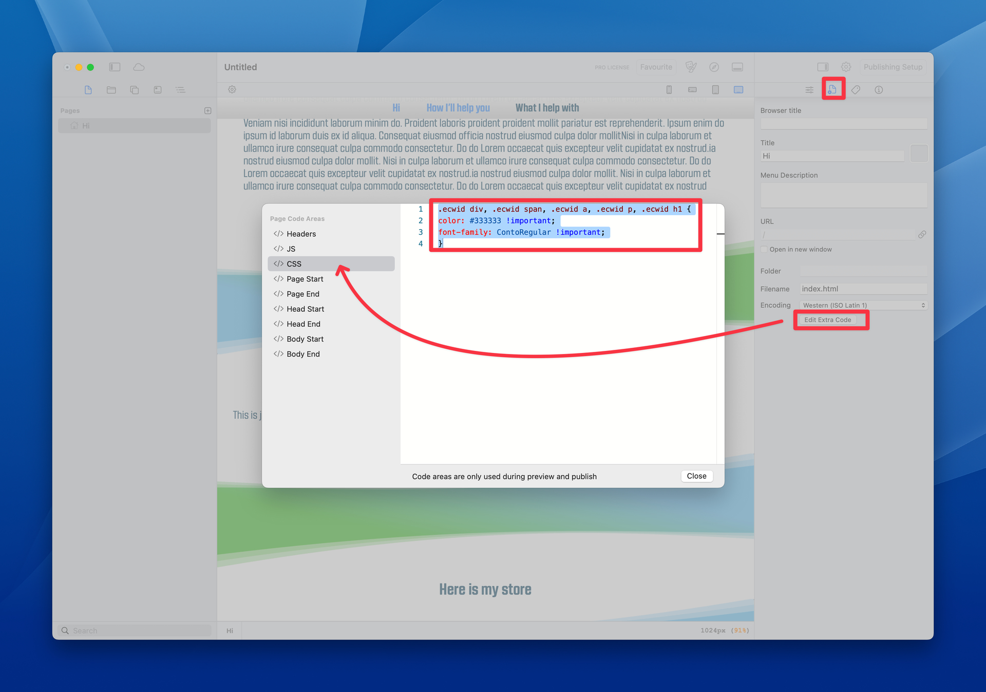

Hi @luckylindy
You can paste the following code into the CSS area in the Extra Code window:
.ecwid div, .ecwid span, .ecwid a, .ecwid p, .ecwid h1 {
color: #333333 !important;
font-family: ContoRegular !important;
However, there is one issue: “ContoRegular” doesn’t exist on your site, so you’ll need to add that to your site before the font will display correctly. How were you doing that in Classic?
