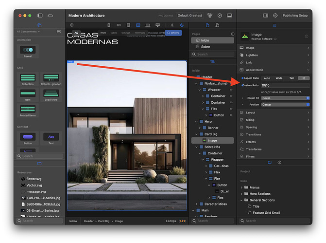

Responsive Overide is not working for image
So Aspect Ratio is not changing as I pin to override as a square. It just keeps as Tall as I placed at mobile.
RapidWeaver Elements 1.4.6 (23911)
You cannot mix aspect and custom at different screen sizes using the blue dots
if you set aspect these are the ratios for auto wide and tall, so if you use custom you set set these or another ratio in the custom area, just dont mix
But aren’t they supposed to?
No
I realy suck with code, and unfortunately it is hard to find time for it. But, how do I fix it?
Okay I got RN, I just can’t set Auto, Tall or Wide, is it right? I should Custom all of the aspect ratio for each breakpoint. Am I Correct?
You can use use either but don’t mix
