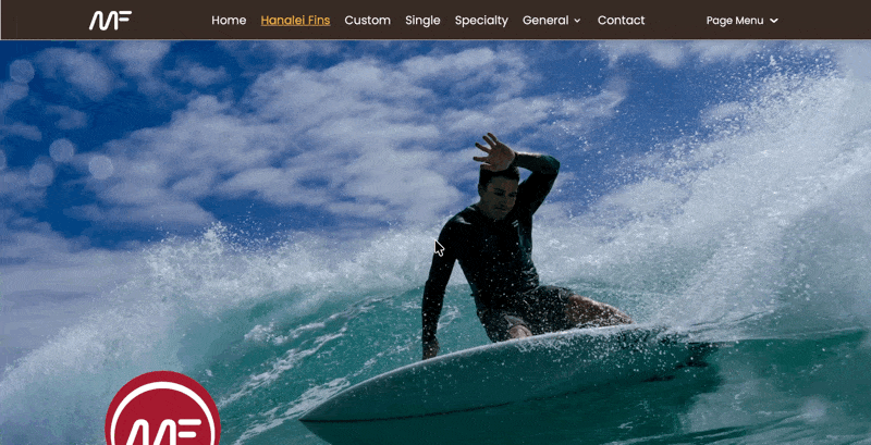

Revised MEGAMenu Approach
After my first attempt at this, which worked relatively well, I decided to try a different approach.
This time I wanted to implement as much of it as possible with the core components, but more importantly, I wanted to use the standard menu component. Because there is no way to hook into the standard menu, I had to be a little sneaky. What I did was add a button in the right drop zone of the menu to serve as my trigger.
Then I created the megamenu I wanted for each of the pages that needed one. These are used to jump between sections within the page so someone can quickly get to a specific section.
The megamenu is shown when you hover over the trigger and goes away when the mouse leaves the megamenu. While in the megamenu, you can click on options, and the page will jump around accordingly.
This is all driven by an Alpine script that is attached to the end of the site template. Shout out to our helpful @elementsbot for helping me sort this out.
Here is what it looks like in action.
CleanShot 2025-08-20 at 12.53.42

Should anyone be interested in why I chose to do this with this approach. It all boils down to the fact that there is no easy way to tap into the standard menu component. So the only customization option is through the drop zone. So I chose that option, not as elegant as doing it on the actual page menu item, but you work with what you have.
Just a small correction. We decided that we DID NOT want to use @portal, instead we placed the script at the end of the project template so it is available globally. We also sprinkled a little Tailwind sauce in the the Advanced section of the page menu properties in the inspector.

For those that are probably asking what did they put in the Advanced section, here it is.
transition-opacity duration-500 ease-in-out opacity-0 pointer-events-none hidden
Some transitioning animation and hiding the page menu initially so there is no flickering when initially opening the page.
If anyone is interested in seeing the code for the script just ask here.

Here is the script. Be aware that for all this to work correctly, the trigger needs to have the same ID as used in the script (or make your matching ones ) `page-menu-trigger` and the page menu needs one as well `page-menu-disclosureThen you have to create the contents of your page menu and the button in the standard menu. The page menu (megamenu if you will) has to be FIXED in the layout and the top placed below the menubar, which in my case is also “sticky”.
<script>
document.addEventListener('DOMContentLoaded', function() {
  var btn = document.getElementById('page-menu-trigger');
  var menu = document.getElementById('page-menu-disclosure');
  if (!btn || !menu) return;
  // set up for fade effect
  menu.classList.add('transition-opacity', 'duration-500', 'ease-in-out', 'opacity-0', 'pointer-events-none', 'hidden');
  let isOpen = false;
  let closeTimeout;
  function showMenu() {
    menu.classList.remove('hidden', 'opacity-0', 'pointer-events-none');
    menu.classList.add('opacity-100', 'pointer-events-auto');
    isOpen = true;
    if (closeTimeout) clearTimeout(closeTimeout);
  function hideMenu() {
    menu.classList.remove('opacity-100', 'pointer-events-auto');
    menu.classList.add('opacity-0', 'pointer-events-none');
    closeTimeout = setTimeout(function() {
      menu.classList.add('hidden');
      isOpen = false;
    }, 400); // match transition
  function toggleMenu() {
    if (isOpen) {
      hideMenu();
    } else {
      showMenu();
  // Hover support (desktop)
  btn.addEventListener('mouseenter', showMenu);
  btn.addEventListener('mouseleave', function() {
      if (!menu.matches(':hover')) hideMenu();
    }, 150);
  menu.addEventListener('mouseenter', showMenu);
  menu.addEventListener('mouseleave', hideMenu);
  // Click/tap to toggle
  btn.addEventListener('click', function(e) {
    e.preventDefault();
    toggleMenu();
    e.stopPropagation(); // don’t trigger doc close
  // Prevent closing when clicking inside menu
  menu.addEventListener('click', function(e) {
  // Click/tap outside to close
  document.addEventListener('click', function(e) {
    // Only close if open AND click is outside both button & menu
    if (isOpen && !menu.contains(e.target) && !btn.contains(e.target)) {
      hideMenu();
  // Touch events for outside close on iOS/Android
  document.addEventListener('touchstart', function(e) {
      hideMenu();
  // Optional: ESC key closes menu (accessibility win)
  document.addEventListener('keydown', function(e) {
    if (isOpen && (e.key === 'Escape' || e.key === 'Esc')) {
      hideMenu();
      btn.blur();
</script>
