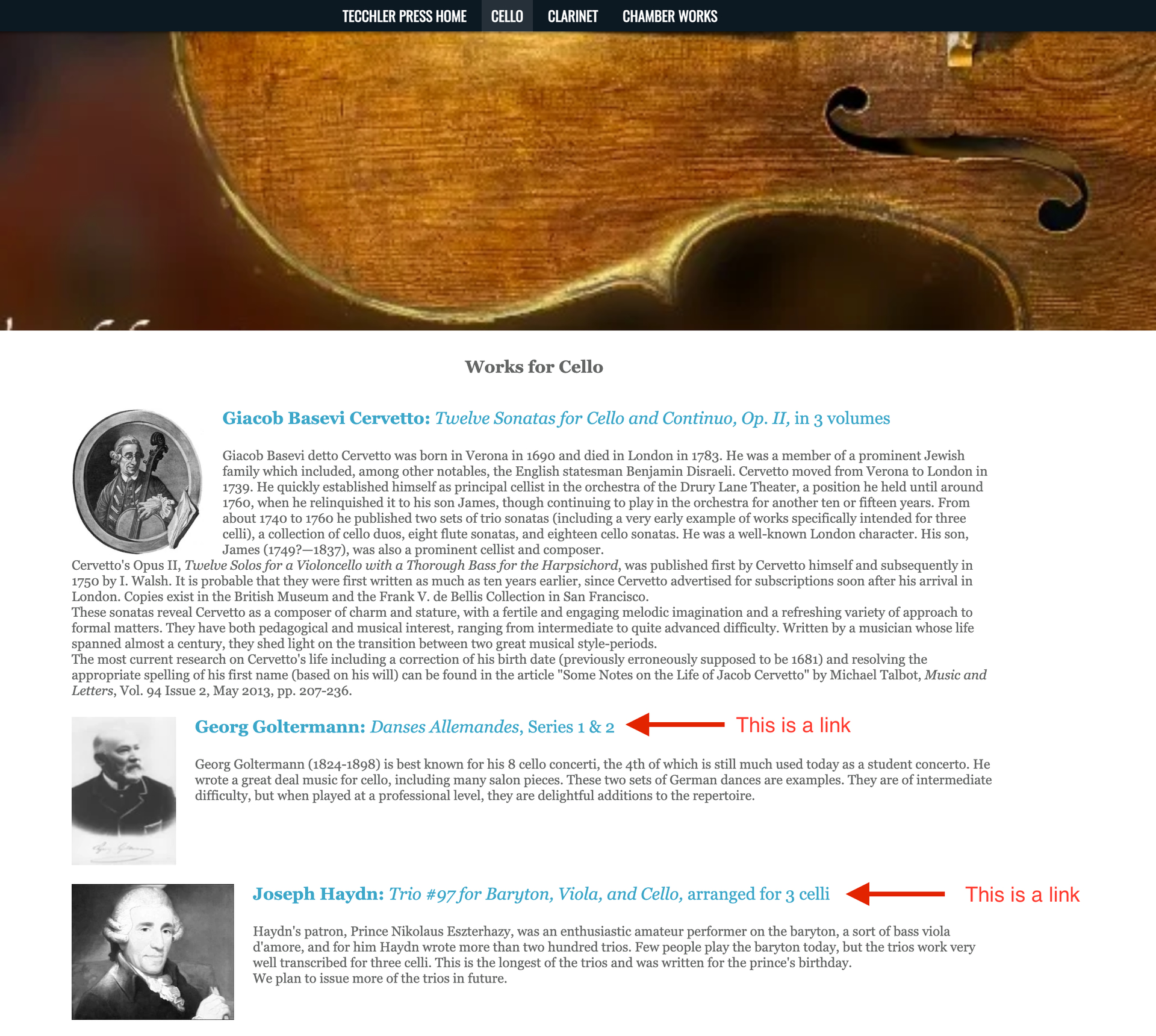

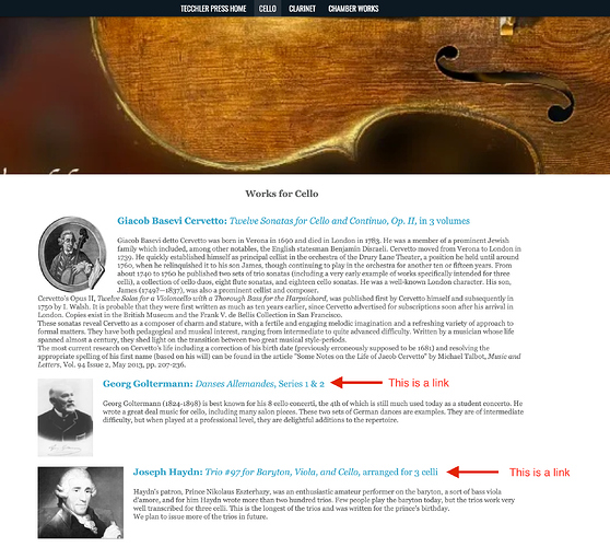

The problems that are still showing up are: From the home page, if you go to the page “Cello”, either by clicking the link called “Cello Music” or by clicking the Cello tab in the site menu bar, you are taken to a page on which the 2nd and 3rd stacks (Goltermann and Haydn), for which the titles should have links like the Cervetto stack, have no links, and Goltermann on the dropdown menu takes you nowhere. But if you go to the Haydn stack from the dropdown menu, and then look at the dropdown menu from there, “Goltermann” has changed to “Goltermann Danses Allemandes”, and that menu item functions properly, taking you to Goltermann page. Hope these details will help.

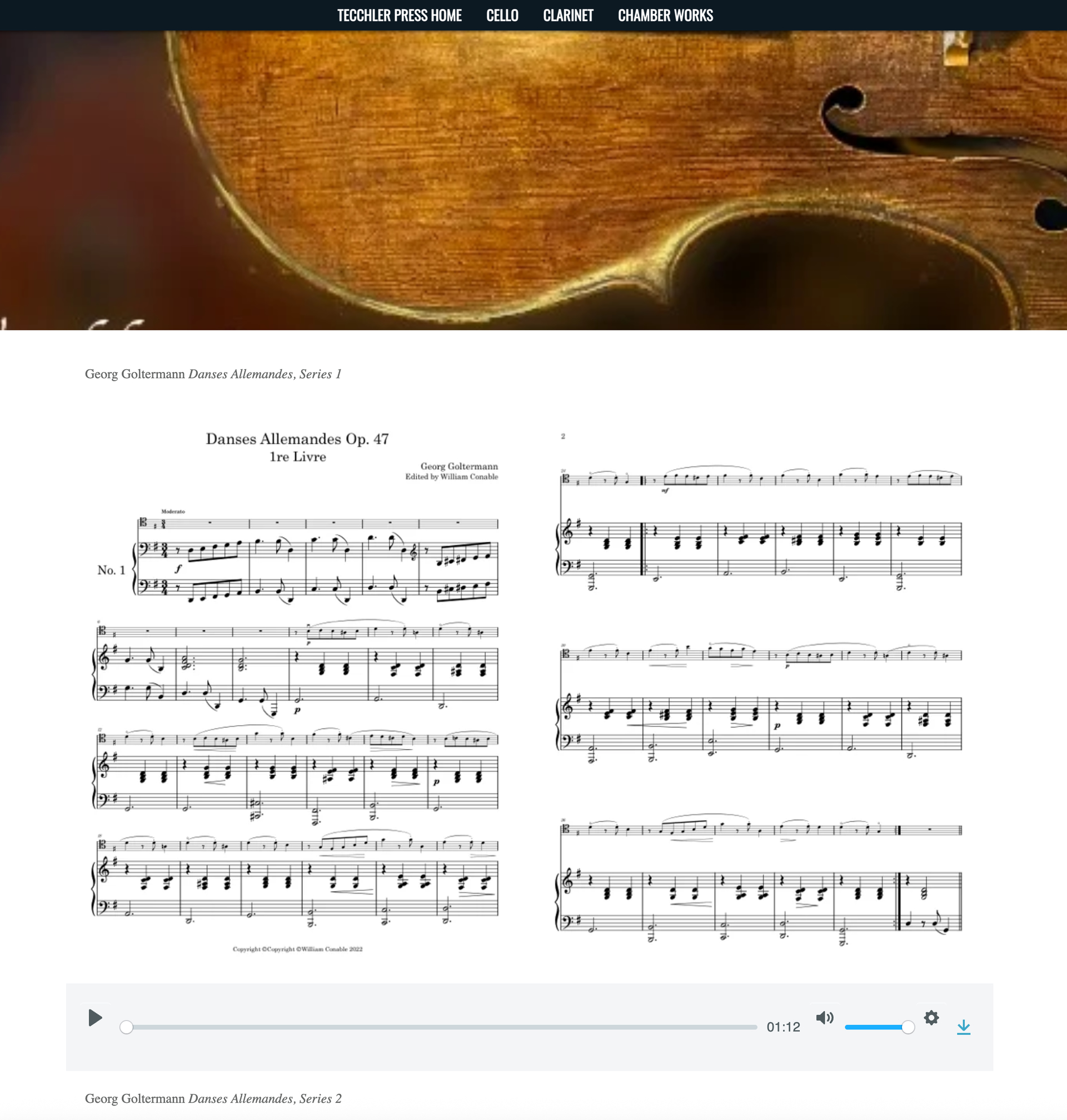

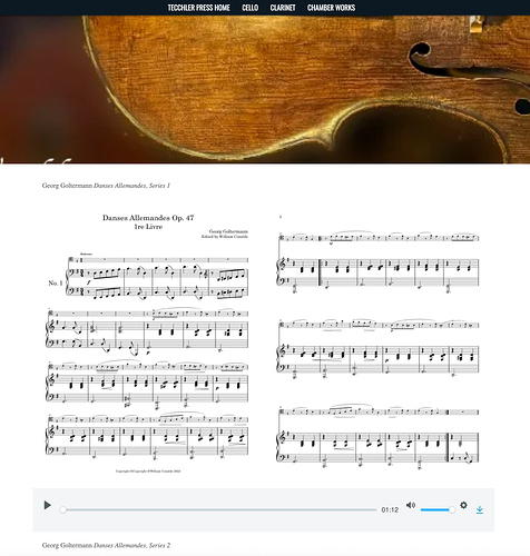

I have never visited your site before, and when I followed these directions, this is what I see:
I don’t see “Goltermann”, I see “Goltermann Danses Allemandes”. I don’t have to click on the Haydn menu item in order to see that, I see “Goltermann Danses Allemandes” from the beginning and it takes me here.
