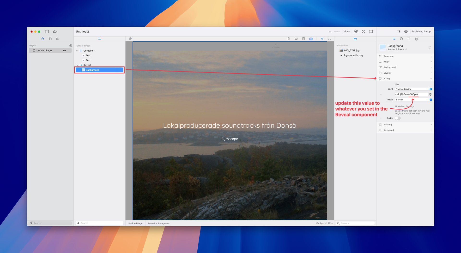

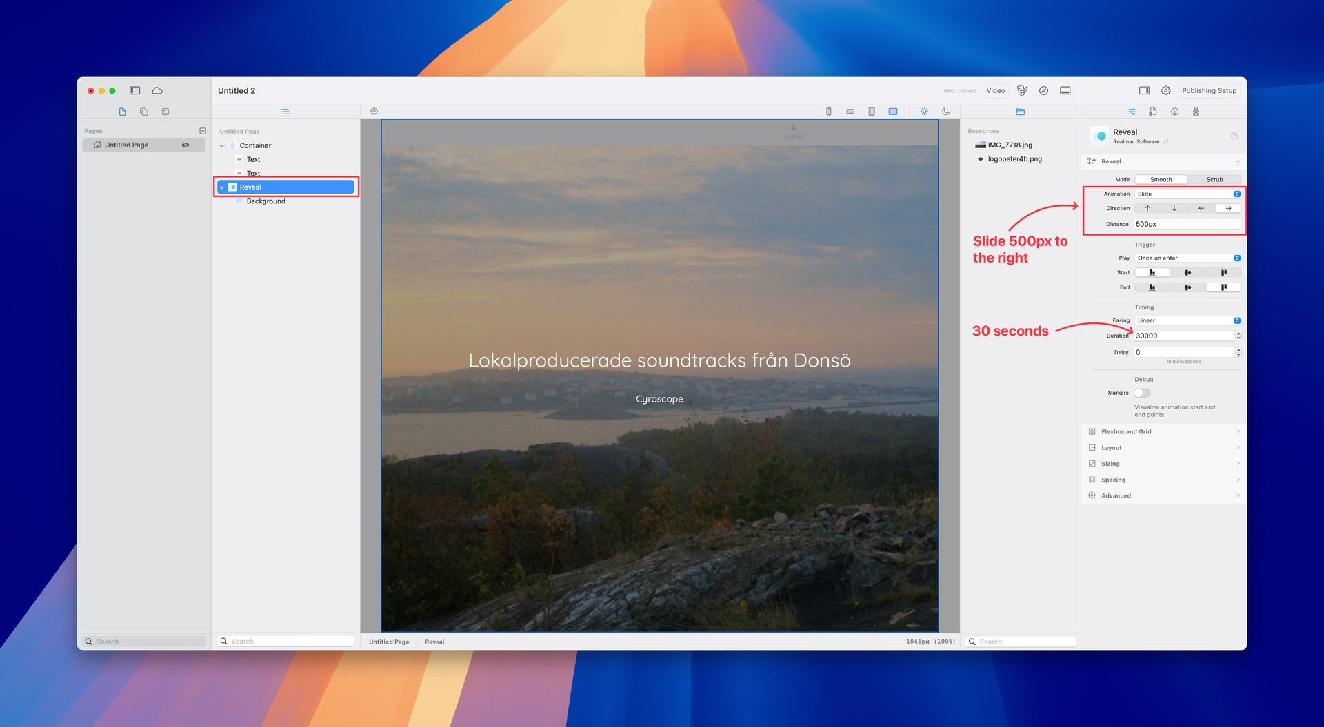

Hi @Cyroscope
You can achieve this effect in a couple of different ways, I’d most likely use a combination of the Reveal and Background components.
I’ve put together a simple demo project that replicates you site’s background and text overlay — Download the project and take a look ![]()
Once you have the project open in Elements simply preview it in the browser to see the smooth transition in action.
Hope that helps, and do let us know if you have any more questions ![]()
