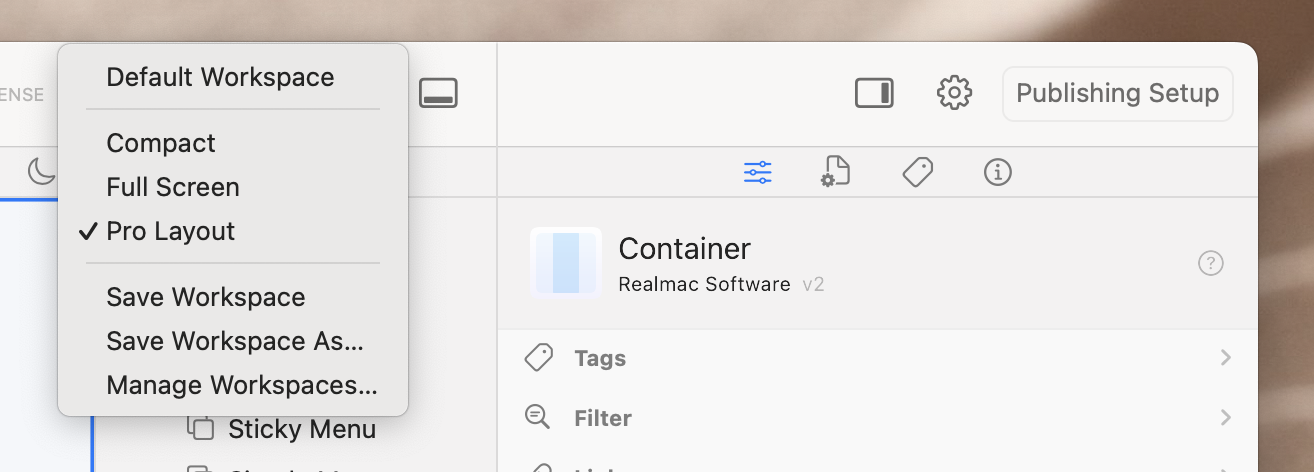

Can you try switching to the “default Layout” and see if the issue still occurs.

@dan Moving, duplicating, or copying and pasting does not resolve the problem.
The solution I could find was to move the Settings panel to a different location within my workspace layout, and then it would work. But on returning it to the original location it would stop working again.
