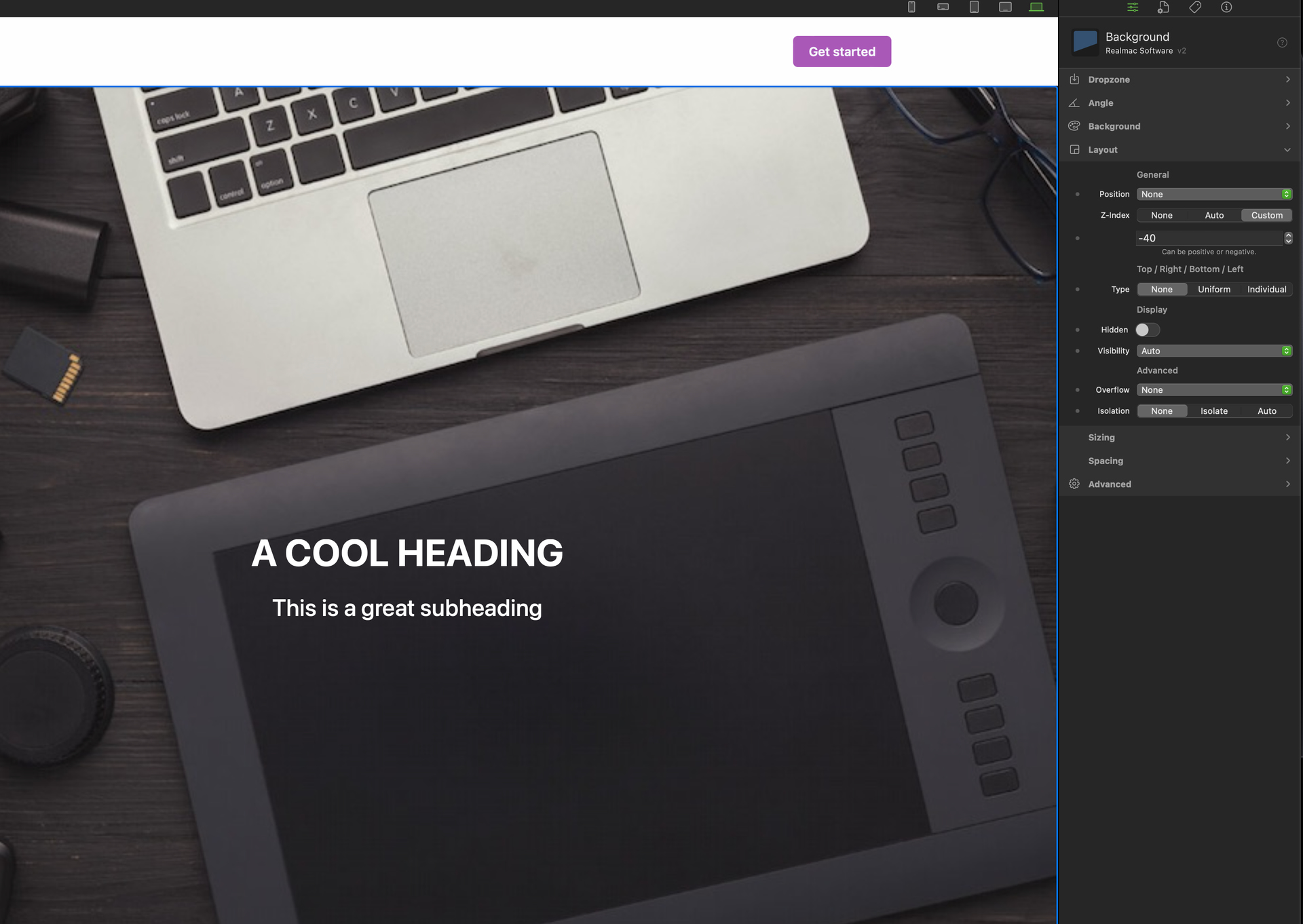

When using a sticky menu what is the easiest way to get the background hero image, slider, or any content to be behind the menubar at the top with no negative space? I did figure out a workaround but I’m curious is there is a simple setting I’m missing. I’ve figured out how to accomplish a ton of complex layouts in Elements and this one thing is irking me that there isn’t a simple solution…or is there?
You change z index to something like -34.
I quickly made this to demonstrate…I threw a sticky menu on top and then a background with a screen height image fill. I set the Z-index to -40 and the sticky menu is white until you scroll down and then the image is in the background of it… I want to always show the image behind the menu without having to start messing around with positioning up.

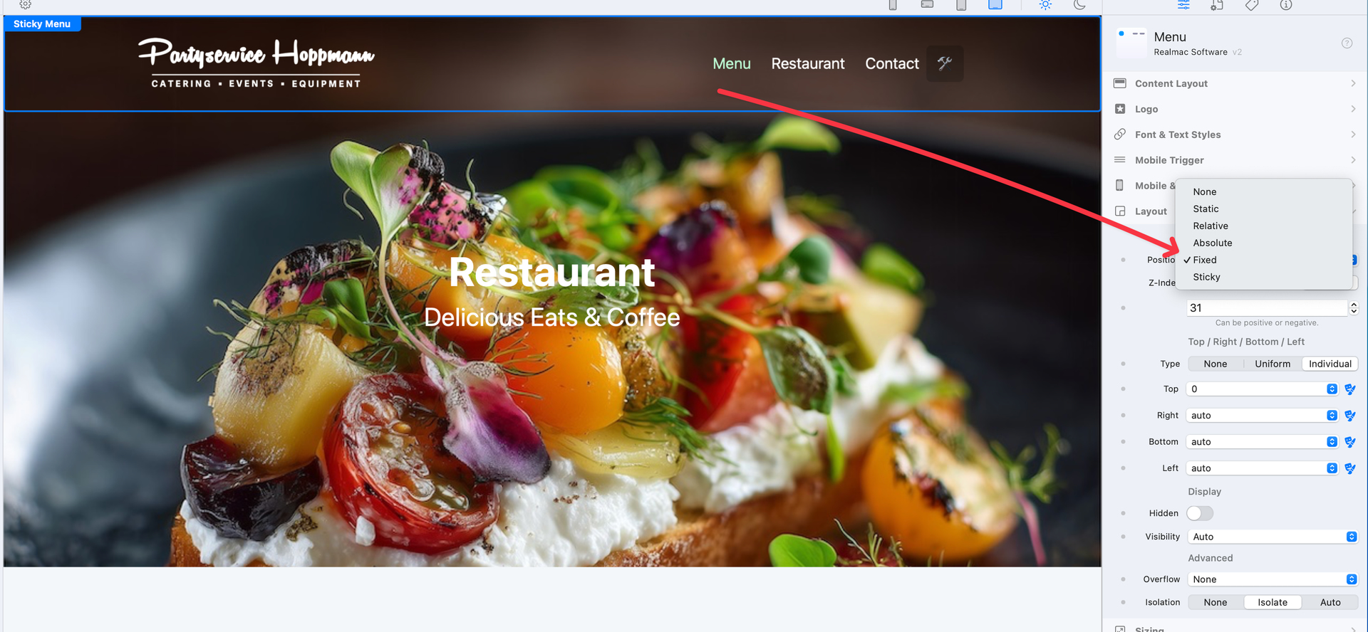

I´m also trying to build a Sticky-Menu like this, on our Classic-Site https://partyservice-hoppmann.de
but I can´t figured out how to setup the Menu settings :hushed_face:

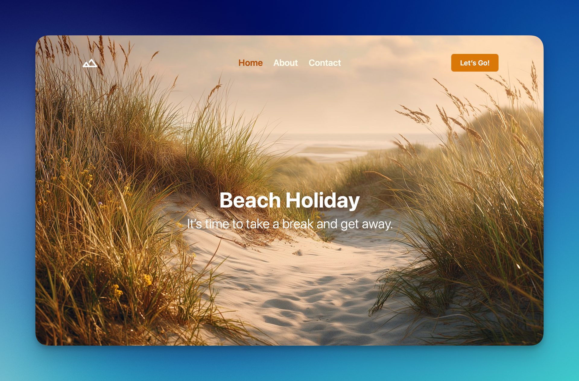

Okay, I had a bit of play and came up with this solution…
It uses the menu component plus a little custom component to apply the magic scrolling effects.
:backhand_index_pointing_right: Open the Project in Elements
Change the Layout from “Sticky” to “Fixed” and that should do it for you (see an example of this in the project above).
Wow. Excellent. Thx Dan :+1:
