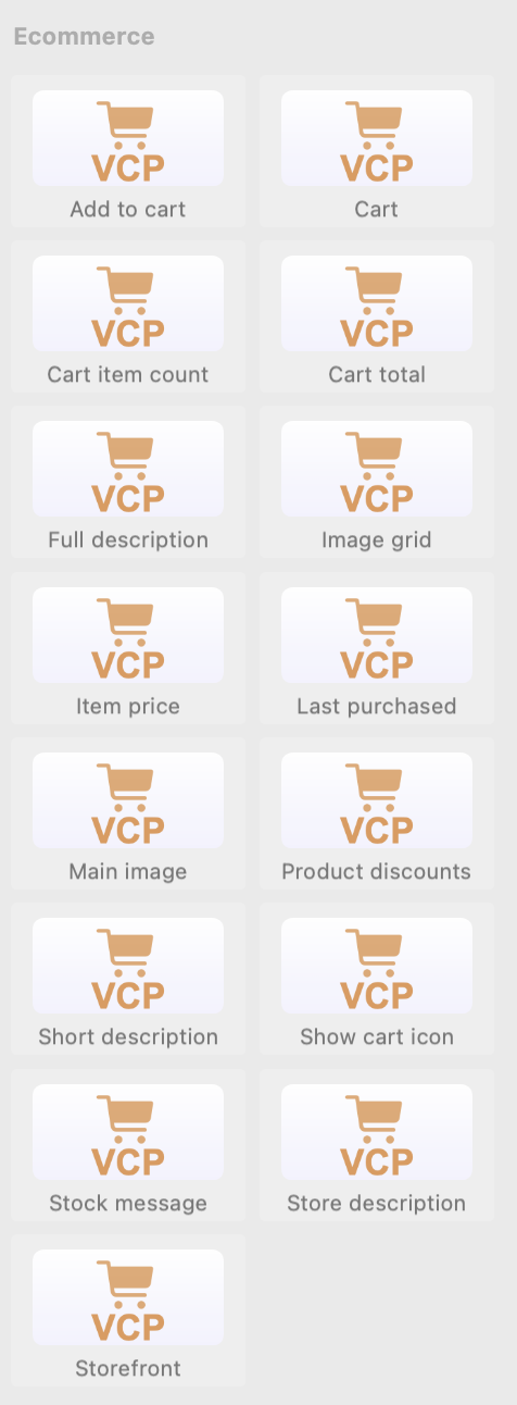

Store Solution For Elements! Vibralogix Up and Running!
Store Solution For Elements! Vibralogix Up and Running!!
Check it out at TrumpetStudio.com
Many Thanks To Vibralogix!!!
Great Company - Great Support
Great. Which product exact? Can’t find anything about Elements on their website.
See here: Vibracart Pro
If you scroll down towards the end of the page, in the Comprehensive manual section, you will see Using Vibracart Pro with Elements.
Thx
