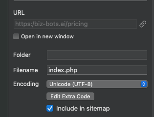

Took a couple of days off to breathe. Since then, I have created a couple of pages from the site, well almost. Anyway, when I publish the site it goes through the routine of publishing 2000+ files and directories. Then it gives me an error. It says, “Multiple index files found on your server”, and that can cause problems. The site is set to use PHP as are those two pages, so I’m totally confused about the error. And when I look at the site with FTP. There’s nothing there. Absolutely nothing, but a folder containing the name of the site.
I’ve uploaded my local file to the cloud elementsapp://downloadDocument/2ptPX5OO088m
I might be wrong but it looks like both pages are called index.php and are trying to publish to the same folder? I can see the URL is different but does that make it publish to a different folder/directory?
Yes it does, Elements will automatically generate a folder structure that matches the page layout you have set up in the project.
Can you post a screenshot showing the contents of the directory where you’re publishing to? During publish, Elements will check to see what files exist on the server and shows this error message if an index.html file and an index.php file have been found in the same location.
