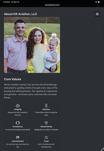

I guess my larger question is I want to understand why the layout would appear different in Elements vs a browser of the same size. These screenshots show what I’m seeing.
Project view in Elements for Portrait iPad size screen
Live site viewed on iPad Pro 11” in Safari
It appears that to control the layout, the Flex elements were given a max width of “Text Max-Width” I disabled them in all of the Components and it did not fix the issue.
I started this project with the Holos theme by 1LD; this content block is from that project file. The behavior appears in the original project file, too. The layout is perfect in Elements, but appears totally differently in the browser.
Ah, you can see this in the editor if you resize the window, maybe you just need to reduce the gap?
Does that fix it for you?
Edit: I also see you’ve changed the default breakpoints (which are standard in Tailwind). I probably wouldn’t do that unless you have a very strong need and understanding of different sized devices and how changing the breakpoints will affect that.
Thanks Steve & @dan!
I see that the Holos theme has changed the standard breakpoints. I’ve got them reset in the Theme Studio from the Empty Project standard and will strip out with that extra width to get everything to display properly.
