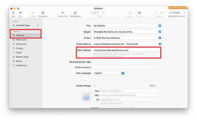

I’ve increased your trust rating on the forum, you can now post a screenshot to help us with diagnosing your issue!
In the meantime, ensure your site address is correctly configured here:
Let me know how you get on.

I attached the screenshot. As I mentioned, I successfully tested the connection setting two ways, but Publish won’t work.

December 4, 2025, 7:51pm
14
The RW site has ,com instead of .com
juliang
(Julian Gómez)
December 5, 2025, 6:27am
15
That’s a typo at your end. If you check my OP, the address was multiply validated.
