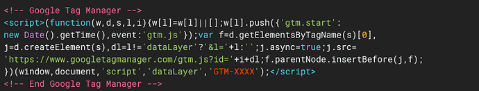

Thanks Greg - That’s what I had done already I duplicated the theme and added there. You can see the specific code right under the opening Body tag here

Looks like your using Google’s Tag Manager. I’m not an expert on that but using the hidden iFrame approach I thought was only for non-JavaScript sites.
I think you can add the tracking code via JavaScript inserted in the head section.
Look under website installation on this link:

The Tag Manager script is placed in HEAD but there’s some HTML code (iFrame as shown below) that has to be placed right after opening BODY tag - if not placed there, Tag Manager analysing doesn’t work. I struggle with that issue right now - trying to optimize to Google new “standards”

As I said I don’t know much about Google tag manager, but I can tell you that the iFrame is surrounded by <noscript> tags so it should only be invoked if the browser has JavaScript turned off (less than 1% worldwide). So my guess is if the tag manager isn’t working it’s probably not that the noscript code is missing.
