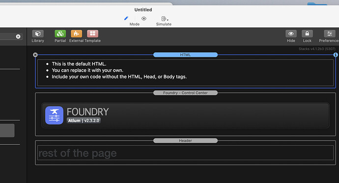

I have my GTM code in an HTML stack which is inside a Partial with my Foundry Control Center and Typeface stacks. It’s the first stack in the partial. I’m pretty sure I created the partial from one stack and then pasted the other stacks in. The HTML stack is the first stack in the partial. It is not in any other stacks. When I view my page source, it’s the first code in the body tag.
When you view the source, make sure you look at an actual source file either exported to a local folder or from the actual folder on the server using a text editor. When I do that, I see that the GTM code is the first code within the body tag. If I just view it through a browser’s dev tools, it’s not the first code. GTM and other scripts can move things around on page load, so you can’t just go by that.
