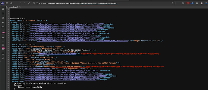

While checking and reviewing the source code, I just discovered that for blog posts in Elements CMS, the SLUG is not being correctly replaced in the rel="canonical" tag.
See the screenshot.
It would be great if this could be fixed so that the blog posts can be indexed by Google.

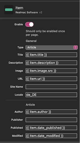

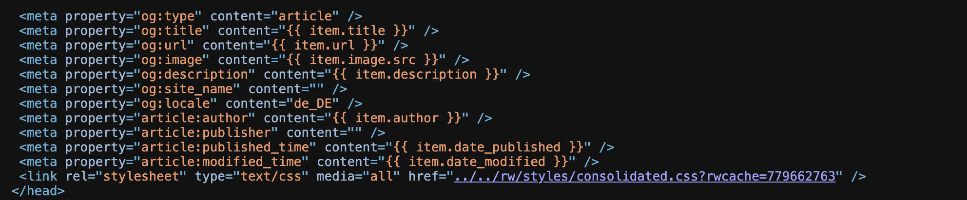

Also, when I activate the Open Graph meta tags under the CMS item, they are also not being replaced or outputted.

  1. The CMS doesn’t currently support updating/setting the canonical URL — we need to add support for that.
  2. The Open Graph tags not being set is a bug — we need to fix that!
I’ve added both of these to the list and will get to them ASAP :slight_smile:
just been digging in to this some more, and the open graph stuff does work on published sites — it won’t work in some situations when previewing locally due to some technical reasons.
The canonical link is more tricky, we will need to add a feature to Elements to make this happen. I can’t say when we’ll get around to this as we have a few other pressing issues we need to get to first.
