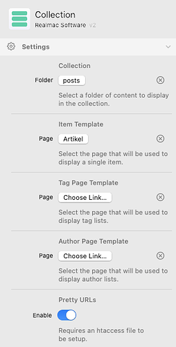

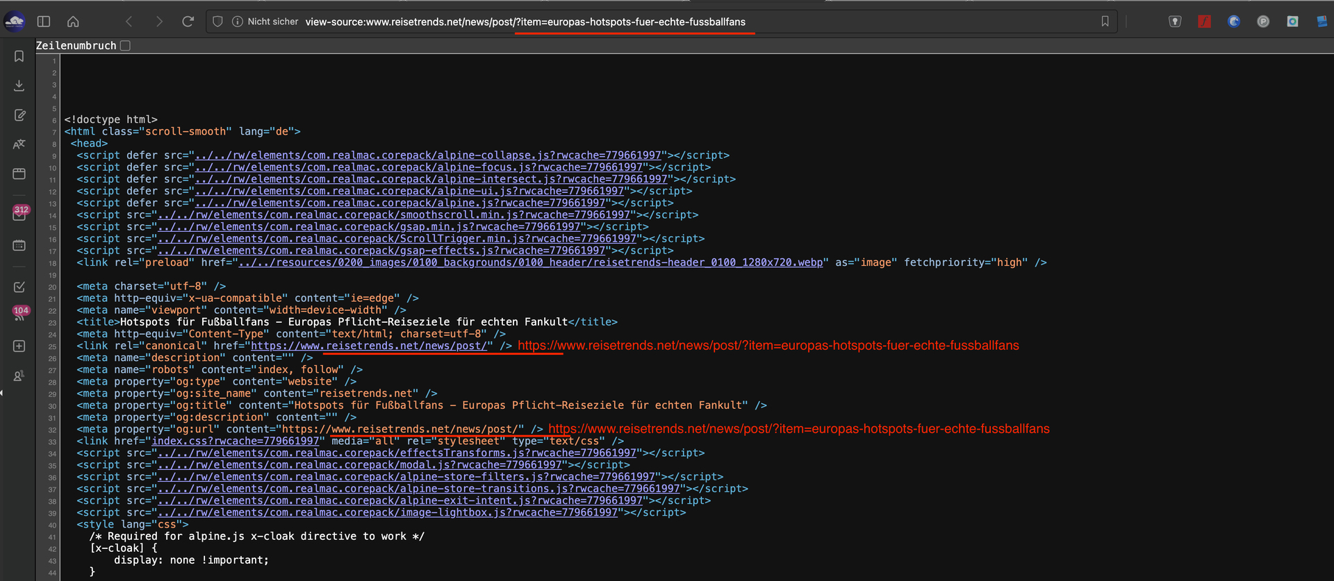

I’m currently trying to set up pretty URLs for my blog in RW Elements.
For that, I entered the following into my .htaccess file:
# Enable the rewrite engine
RewriteEngine On
RewriteBase /
# 1) Redirect old links to Pretty URL
# Example: /blog/post/?item=slug -> /blog/slug
RewriteCond %{QUERY_STRING} ^item=([^&]+)$
RewriteRule ^news/post/$ /news/%1? [R=301,L]
# 2) Internally rewrite Pretty URLs
# Example: /blog/slug -> /blog/post/?item=slug
RewriteRule ^news/([^/]+)/?$ news/post/?item=$1 [L,QSA]
Unfortunately, this hasn’t worked for me so far.
Has anyone successfully managed to use pretty URLs with Elements before?
Could someone give me a tip on what the correct .htaccess entry should look like?

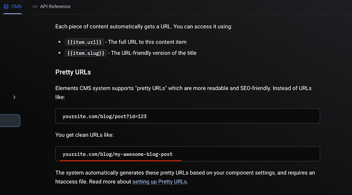

I have spent several days trying to transform the current Elements CMS blog slug into a meaningful structure, specifically into /blog/?item=my-blog-post.
I’ve tried numerous .htaccess entries, as well as changing the index.php in the post folder to post.php, similar to how it’s done with Total CMS, and made the corresponding .htaccess entries.
Unfortunately, all these attempts have failed.
@ben
Ideally, I would like to set up my blogs so that the ‘post’ folder does not always appear between my blog and the blog slug. How can I do this?

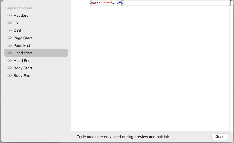

You will then need to add the following “base” tag to the <head> area of your project’s template:
<base href="/">
<!-- OR if you're publishing to a subfolder: -->
<base href="/subfolder/">
This ensures that URL like /post/my-first-post is rewritten under the hood to /post/index.php?item=my-first-post.
Obviously “post” can be anything you want, you just need to ensure your update the htaccess code to match whatever you’ve called the folder in Elements.

I’ve fixed this issue. This is the corresponding .htaccess:
RewriteEngine On
# A) Redirect: index.php?item=slug → /slug
RewriteCond %{THE_REQUEST} \s/+[^?\s]*/?(index\.php)?\?item=([^&\s]+) [NC]
RewriteCond %{REQUEST_METHOD} ^(GET|HEAD)$
RewriteRule ^(index\.php)?$ %2 [R=301,L]
# B) Rewrite: /slug → index.php?item=slug
RewriteCond %{REQUEST_FILENAME} !-f
RewriteCond %{REQUEST_FILENAME} !-d
RewriteRule ^([^/]+)/?$ index.php?item=$1 [L,QSA]

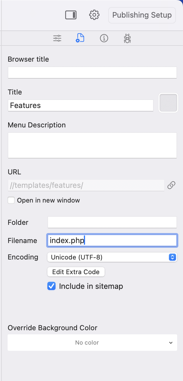

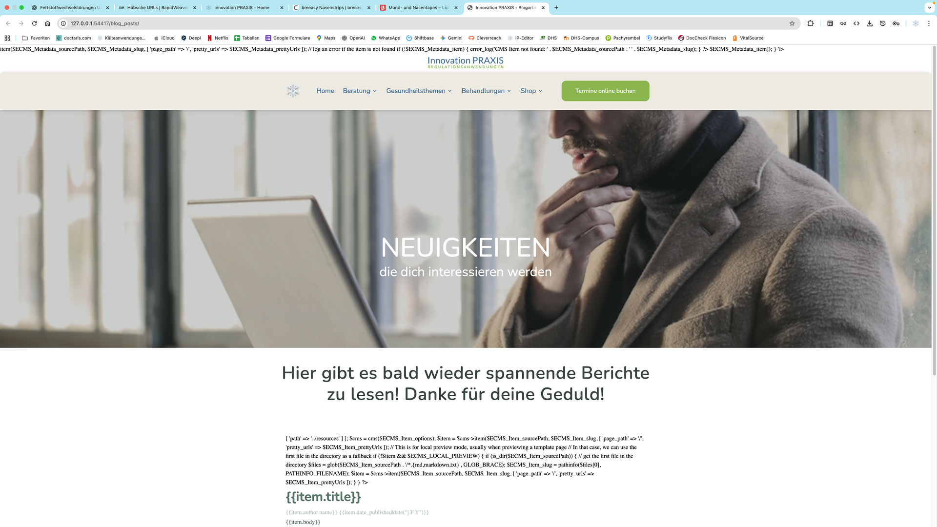

I have already tried a few times to integrate CMS into my own website, but unfortunately I have failed every time.
This is a shame, because I have now completely moved away from RW classic and rebuilt my website from scratch using Elements. I think this has worked out quite well so far, but I still have to do without the blog posts, which are read quite frequently.
I have tried to transfer the structure of @Ben’s Appleseed News to my site, but it doesn’t seem to work (see screenshot).
I hope there will be good news on this very soon.

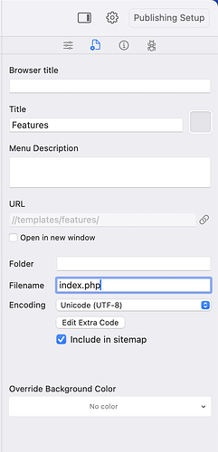

Looks like you need to change the page extension to be php, you can do this via the page settings:
YES! Totally wright!
