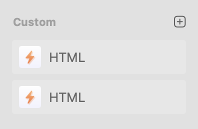

When trying to rename a custom HTML component, I only get two options to duplicate or delete it. I can rename it once it has been placed onto page.
The problem comes if I need to create two or more different HTML components with different code. I can’t tell which HTML component is which when considering adding one of them to a page.
Is there a way to either rename or put a description with that HTML component to know what code is in them?

I am not sure how to rename them in a code editor. I can preview the code in the Inspector panel. What code editor are you referring to?
This is the issue I have. These won’t rename. If I drag one of these onto the page layout panel, I can rename them. However, what good is having two HTML custom components if you can’t know what is inside them.

Looking at your screenshot you obviously create two components but never gave them names in the code editor.
With one of the HTML custom components selected, in a layout, open the code editor, click on the title and rename. Do the same with the other one.
Thanks. I did not see that you could change the “HTML” label to a different name. That worked well. Thanks again.
