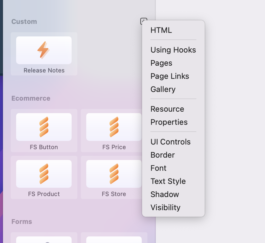

Have a look through the custom components getting started guide here.
There’s some example custom components in the drop down list, these are good to add and poke around in:
We also have a Component Dev Category, that’s worth a browse through
And once you’ve got the hang of custom components you can look at migrating them to full on dev packs…
Have a browse and a watch of the videos then follow up with any questions you have, we’re always around to help :slight_smile:
@dan dont think I ever clicked on any of the items in the dropdown list I only clicked on HTML not sure why I didn’t click on them, just went straight for html
@dan Why didn’t I look at some of these other options sooner? I learnt an awful lot from them.
