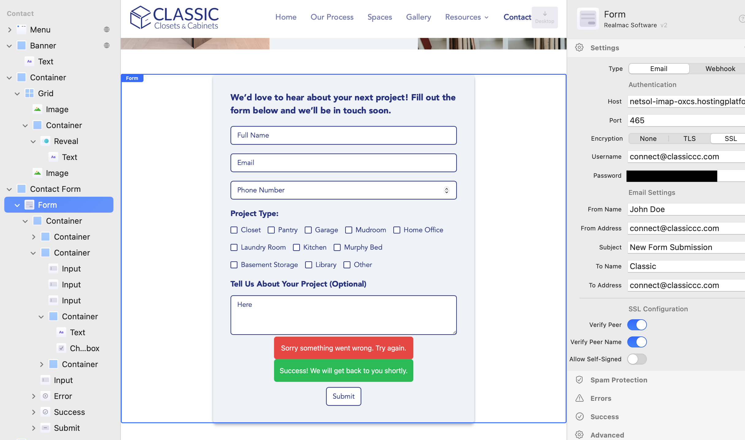

Hello, I’m experiencing an issue with the contact form on my website’s Contact page. When I try to send a message through it, I receive an error. Could you please take a look and help me resolve this?
I see a couple of issues that will stop your form from working …
  1. All the components that make up the contact form need to be “inside” the Form component. At the moment only the Error and Success components are correctly positioned.
  2. The Form component has the Type set to “Webhook”. Was this the intention? If so you will need to specify a Webhook URL. If you want the form to send an email, you need to set Type to “Email” and provide the details requested.
Hope this helps.
Thanks for taking a look at this! Just to clarify, all of the components (except the back container) are already inside the Form component. Also, the Type is currently set to ‘Email,’ not ‘Webhook.’ Could you take another look and let me know what else might be causing the error?
And you are running PHP 8.1 or greater on the server?
Yes, I am running 8.2

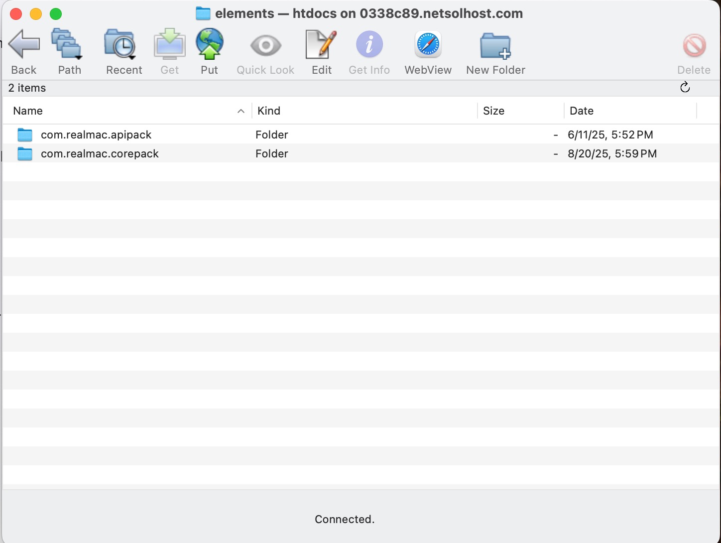

I’ve followed the directions for checking the form logs, but the only logs I can find are under com.realmac.apipack, not com.realmac.corepack as the instructions mention. The second screenshot I attached shows the only log that appears. I’ve tried everything else I can think of to get this form working, but I’m still running into issues. Could you help me figure out what’s going wrong?
This is the final issue we need to resolve before announcing our updated website. Could you please assist?

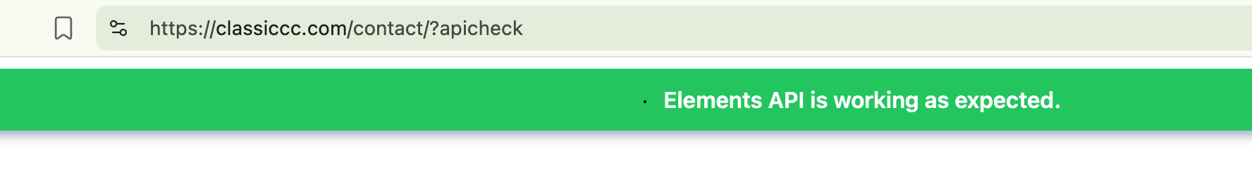

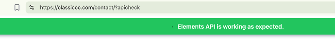

The Form API is working ok on your server so that looks good:
I see an error when trying to submit the form though:

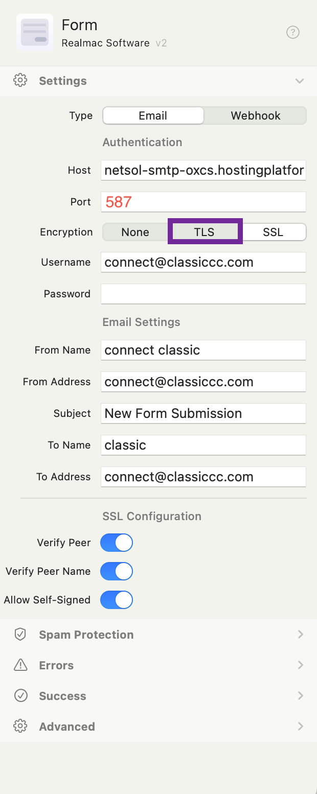

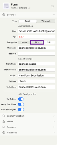

The error’s similar to another one we saw a few days ago. Looks like you are using Network Solutions as your mail provider, is that right? I checked their help docs and they mention trying to use port 587 and TLS for outgoing mail. Could you adjust the Port and Encryption fields in your form settings like below?
Then re-publish all files and try testing the form again to see if it works. Make sure you are using the correct email address and password too.
Let us know how you get on.
With those changes made it still didn’t work unfortunately.

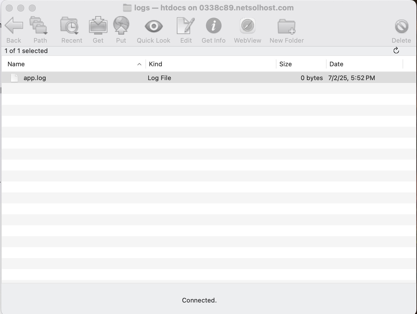

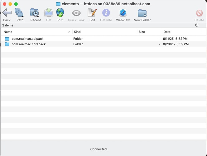

Are you seeing any logs being generated now? I see you weren’t seeing anything before, but wanted to check if perhaps you could see some log files there now.
Information on where to check for those log files below:
We are now seeing logs in the correct place. What do we do with them?

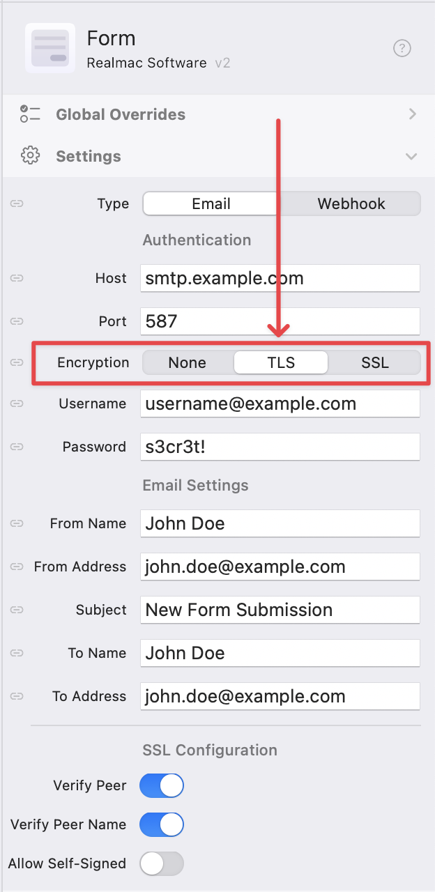

I can see from the logs that you are still using “SSL” rather than “TLS” (as suggested by @differentdan above). Please change the Encryption setting to TLS, republish your site, and try to submit the form again.
Hopefully once you’ve done this, your form will begin working as expected. Let us know how you get on :slight_smile:
I have switched it to TLS and it still doesn’t work. We have tried every combination of settings for the past month and nothing has worked. Our current website was built with Rapid Weaver and Foundry, we are using the same email settings and that form works. Please help, this is the last piece of the website that needs to be finished before we publish. We have pushed the publish date multiple times due to this issue. Thank you
