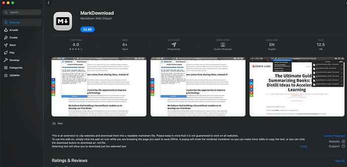

Thom, speaking of the right tools, I can’t get past step 1 so far. “Find the MarkDownload (MD) plug-in for Safari.”
Where do I find the Safari Markdown plugin? When I search for MarkDownload (MD) plug-in for Safari in the App store, all kinds of apps show up that have nothing to do with saving a page as a markdown file.
I’ve downloaded Mark Down Editor but it’s not a plugin. I downloaded Single File plugin that saves the page as html and I downloaded Copy Link in Markdown that copies only the link.
It’s also unclear to me if this method will maintain photos associated with my posts.
assume this one?
Correct.
  1. Open the macOS App Store.
  2. Search for MarkDownload.
  3. Buy and download it.
  4. Once in your Application folder doubleclick on it and follow instructions to add as an extension to Safari.
I prefer One Markdown to Markdown Editor.
Also note that some of the Markdown things described in Markdown Editor don’t work in the CMS.
As for images, you should get them when you clip the page with MarkDownload. But it’ll be an inline reference. One of the things that just needs more step-by-step documentation is how to handle external image references in the CMS properly.
