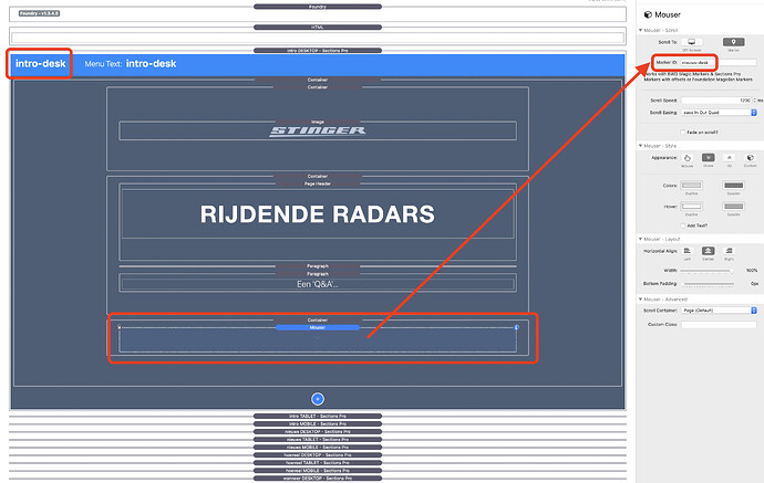

Hi Dan,
On a trial url I rebuilt the page with Sections Pro + Mouser, but something odd is going on. When clicking the first scroll down button, all is well, and you are taken to the 2nd section. However, from then on, when clicking on any subsequent scroll down button, complete sections get skipped…
I triple checked the Section Pro Marker ID’s - where it goes wrong first - and where you are supposed to go from the ‘Sections Pro’ section called ‘nieuws’ to section called 'hoeveel, but you are not. In stead, you get taken to the section below that. Etc. I am pretty sure I have inputted al the Marker ID’s correctly though…
Any idea what I did wrong or could this be a bug?
Thanks,
Jimmy

Hi and thank you so very much for your input. Actually, I used each of the 10 Marker ID’s three times, as there are 10 sections and each section I made for respectively Dekstop only, Tablet only, and Mobile only - so hiding each stack for the other two screen sizes in each case. I figured that because of these hiding actions, I could get away with given them the same Marker ID’s. Anyway, just to be sure, I gave each section a unique Marker ID just now. Unfortunately, however…
…the problem persists.
Just in case I double checked that all the Mousers are pointing to the correct Marker ID and that all the Magellan Marker ID’s are unique and correct. I think they are.
Let me share some screen shots…
I really appreciate your quick help! Thank you.
