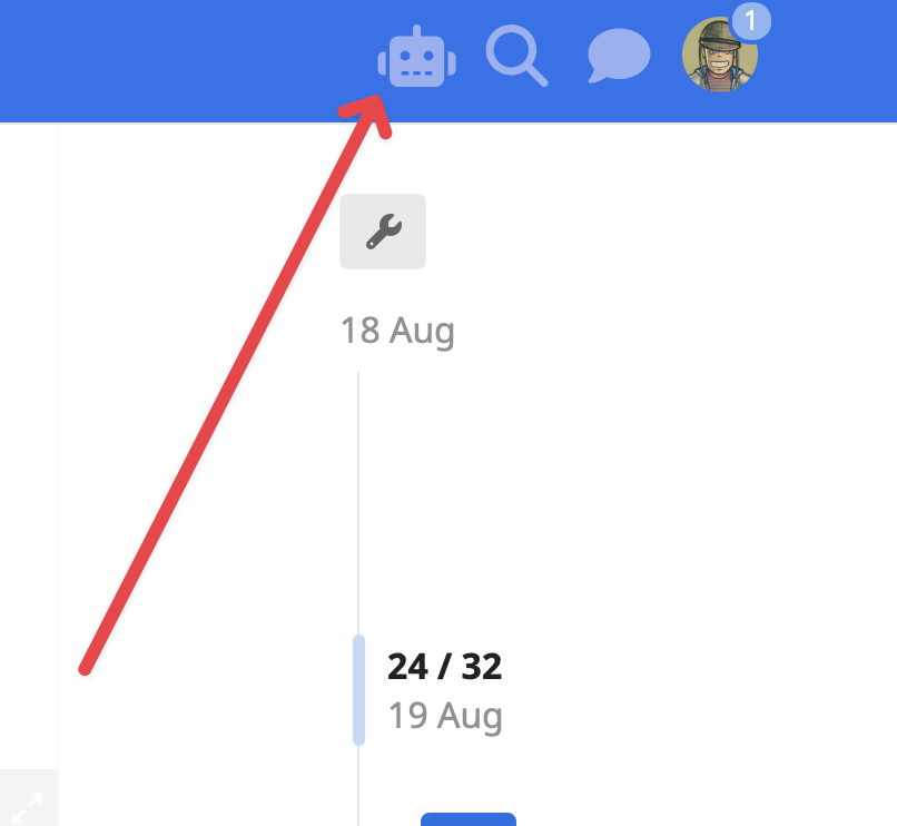

P.S. you can also have private chats with the bot, using this button…
oops I dint know they could be private! lol :slight_smile:
