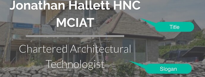

I want to change Font and size for the Engineer Theme
I am making a site using the Engineer Theme which I really like but I Cannot find a way to change the title font and size.
I have searched and someone pasted a CSS code, I have tried that but it changed nothing. The code was
    font-family: ‘Open Sans’, sans-serif;
    line-height: 140%;
The title I want to change is on this page
http://www.jehallett.co.uk/test
OK,
I’m assuming you want to change is the title in the hero area?
For the Title itself try adding this:
h1.hero-title {
    font-size: 4.5rem;
If you want to change the “slogan” as well then try adding this:
p.hero-slogan.display-4 {
    font-size: 4rem;
