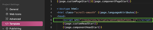

i’ve also had problems adding JS code to my projects lately. after many tests (and asking the elementi-bot!), i now put my JS-code in a separate file, like Dan shows in his video.
maybe this way will help you …

instead of using “{{assetPath}}”, I always use the hardcoded way for the path.

however, if I instead use <script src="{{resourcePath}}/sonntagsButtons.js"></script>, my script also no longer works.
edit: ok. i have to use: <script src="{{page.resourcesPath}}/scripts/sonntagsbuttons.js"></script>
that’ works for me

<script src="{{resourcePath}}/sonntagssuttons.js">
but this works
