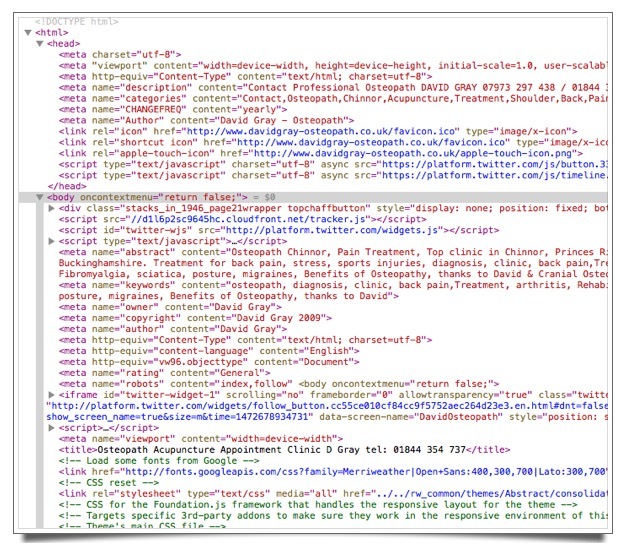

The page looks pretty messed up in the console. Somehow you have managed to get all the code that should be in the head inside the body tags instead. If you could post the code you are using in site wide, and state which site wide field it is added to please.

FTR: Things still don’t look right there. I’d expect to see a lot of the stuff after your opening body tag in the head section.
Maybe you amended the theme file? (see attached).
