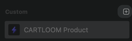

You can add custom HTML code to your project by creating a custom component. Select the HTML custom component and then paste you HTML code in there. Rename the component to suit. Add properties to the custom component if needed. Click on the “+” icon and you will get a dropdown with a lot of different options, the first one will be HTML.

  1. Create a Custom HTML Component
    • Click the + in the Custom area and choose HTML.
