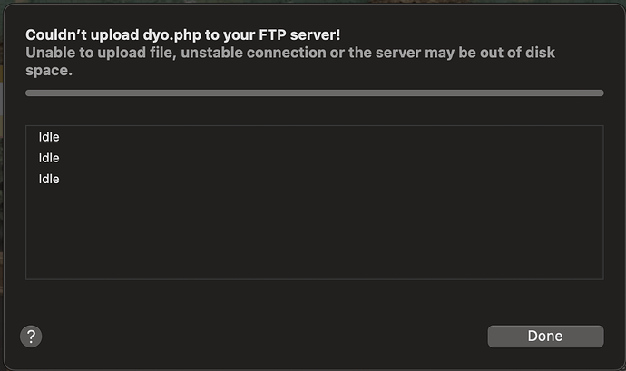

@dan with version 1.0.3 now i have problems with uploading. i never had these before …
Can you check if you’re out of disk space on your server? as that’s what the error message suggests.
If you do have disk space on the server, can you enable upload logging and send us the logs.

i’m very sure i have enough disk space and i’m back to v1.0

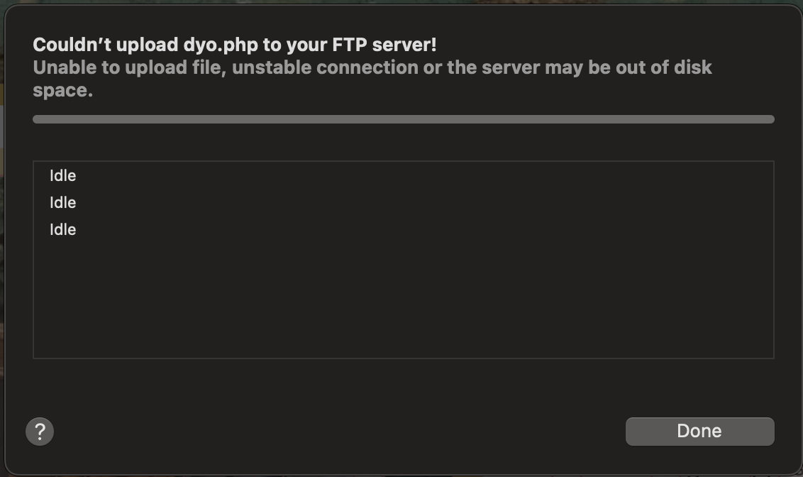

same problems with this version. now i have set the connections to 2-slow … and it stopped just before the 97% target this time
@dan
by setting the conncetions to 1-slowest the upload was now successful.

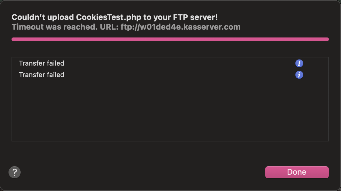

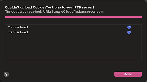

same project different error message during upload:
