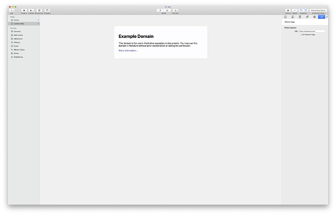

So add an offsite page type to the website. Give the page a name like “Contact Me” and then give it any random link of like https://example.com/ in the Page Inspector.
Then copy and paste this code into Settings > Code > Body:

Like this:
