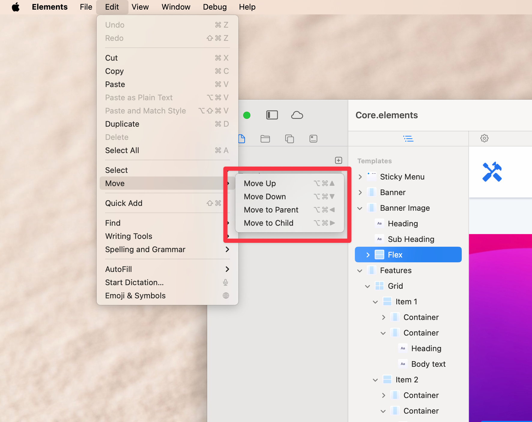

I know it can be a bit fiddly sometimes, you just need to know where to drag it. We can certainly look at ways to improve it in the future (we have a few bigger issues to take care of first before we get to the nitty-gritty polish).
However, right now I’d recommend using the keyboard shortcuts if you’re having issues moving components, these are really good once you get used to them…
And here’s a video of me just messing around by moving a component in the tree with the keyboard shortcuts:
Hope that helps in the short-term!
