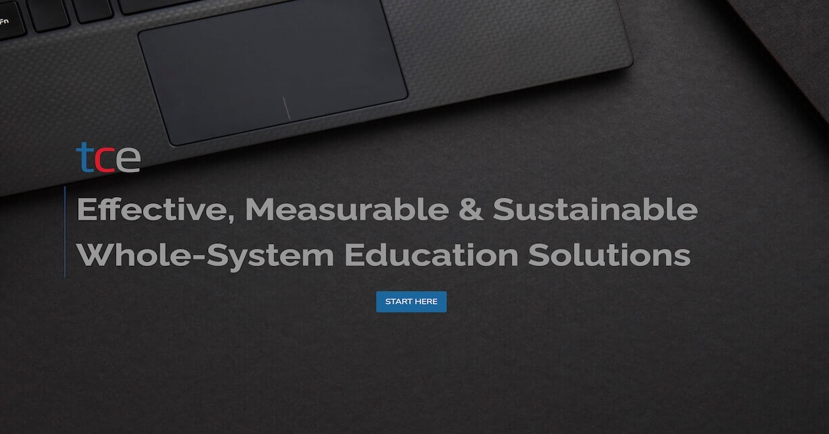

Folks,
Just recently some visitors to my site using Chrome have been getting the insecure warning “attackers may be trying to…”, etc. etc. I know the certificate is valid - Chrome knows it is too, if you go deep enough. It shows up as secure in Safari, etc., but the warnings are beginning to cause me problems. Does anyone have any inkling as to why this might be happening:
Many thanks in advance.
Gavin

Tried your website with the mobile version of Google Chrome and everything was fine.
By the way, nice website.
Thanks Sharky - I’m happy with it for the moment, but this issue is causing a few people to be put off due to the Chrome warning of ‘attackers’. I’d love to find a solution to this, but I’ve been looking for about four weeks now, with no luck.
I visited the site on Chrome and got the warning to stay away, once on your site the insecure warning was shown, saying the site’s cert is not valid but upon clicking the further details Chrome says it is valid. A bit confusing.
