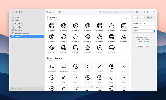

For now I think I’ll stick with IconJar.
UPDATE: it does do the right thing if you use the Export button, the problems I encountered seemed to be it not respecting the settings when dragging the icon out of the app.
sounds like an issue with the Nucleo app, I guess you’ll have to export the icons rather than dragging them directly out of the app.
I’m now using IconJar - it’s a MUCH nicer Mac app, although you do have to buy/download your own icon sets…
I’ve been using it with Elements and it works great :ok_hand:
Yes, I have been testing this out myself and it feels like a great solution.
I just discovered the SVG Cleaner in IconJar, this is very handy as it allows you to tweak any SVG file.
