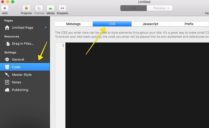

@joe Paste the code into the site-wide CSS, that way it will apply to every page in your site. You can then delete it from the page inspector where you have it now - that applies only to the page that it is on. You would need to replicate it on every page the same, hence why site-wide is a better choice.

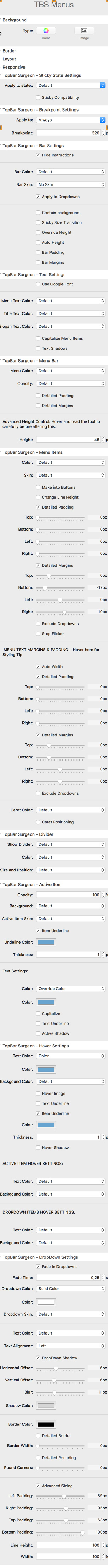

You can stop the underlines in the dropdown menu with the following CSS although the overlapping problem is only occurring because of some of your padding changes. There is an Advanced Sizing option in the TBS dropdown settings that allows you to style the padding separately from the main bar items and counteract some of the changes that you have made to the top level items.

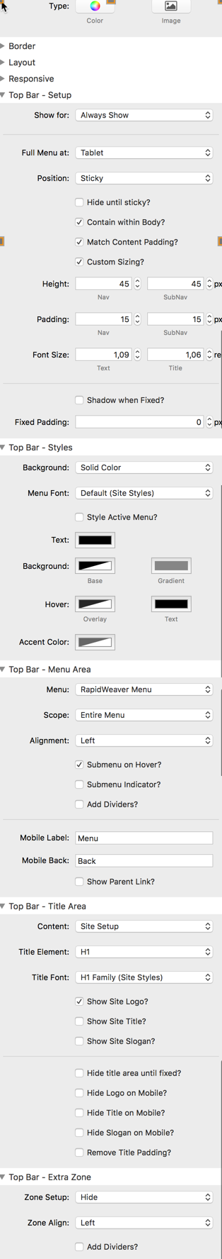

Check the Submenu indicator setting in the topbar stack - i.e turn it back to its default ON state.
