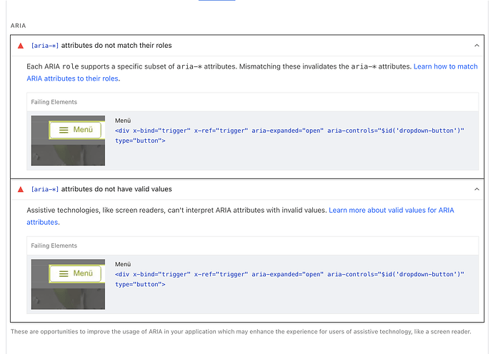

in my case, for example when i put a dropdown component in my header i get the following error message and have no way to fix it

I have asked elementsbot about this. It seems that the aria labels in the dropdown component are not being set correctly.
Can this be fixed in a future update
Great catch, Pegasus!
You’re running into a classic accessibility gotcha: your ARIA attributes’ values don’t match what assistive tech expects. Here’s what’s happening in your example:
<div x-bind="trigger" x-ref="trigger" aria-expanded="open" aria-controls="$id('dropdown-button')" type="button">
Problems Detected
1. aria-expanded="open"
WRONG: aria-expanded only accepts "true", "false", "undefined", or "mixed".
Yours: "open" ← Invalid!
How it should be:
aria-expanded="true"
aria-expanded="false"
2. aria-controls="$id('dropdown-button')"
Yours: "$id('dropdown-button')" is a template string. If not rendered to a real ID like aria-controls="menu-123", this is invalid.
How it should be: Replace with the actual id of the content you’re controlling.
3. type="button" on a <div>
Only allowed on <button> elements. Not an ARIA thing, but also flagged.
What Should You Do in Elements?
Use a <button> as your dropdown trigger whenever possible.
Make sure its ARIA attributes look like:
<button
aria-expanded="false" <!-- true or false, never open/closed -->
aria-controls="dropdown-1" <!-- must match the menu's id -->
type="button"
Menu
</button>
The dropdown menu itself should have that id:
<div id="dropdown-1" ...> ... </div>
How to Fix in Elements
You can:
Edit the Dropdown trigger to ensure it’s a Button
Double-check the ARIA properties (most built-in Elements components do this right, but if you’re hand-coding or using a 3rd-party component, watch out!)
More Goodness
Read up on ARIA attributes & valid values or check the Elements Accessibility doc .
And, if you’re stuck with a misbehaving Marketplace component: tag me with the property file or ping Dan — we want the marketplace squeaky clean.
Quick Fix:
Change "open" → "true"/"false"
Make sure ARIA points to a real, unique id on your dropdown menu
Use <button>, not <div>, for interactive triggers
If you need to see how this looks in an Elements custom property file, let me know — happy to give an example!
