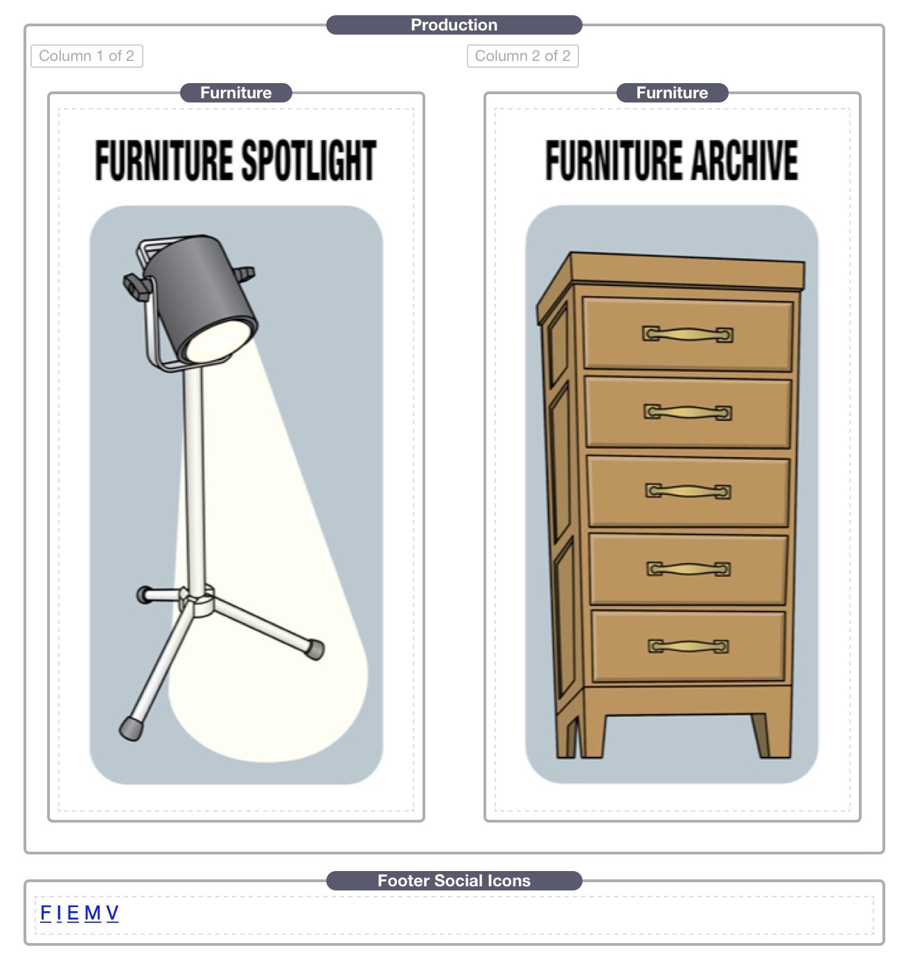

If you’re using Stacks 3 another way to do it would be use Joe Workman’s Houdini stack.
- Add a Houdini stack
- Set it to ‘sidebar’
- Pop an HTML stack inside it and add your code
- Save the lot as a partial
- Add it to every page

I have used copy and paste, or duplicated pages to add the code to all the pages, but I am concerned about the need to make a change down the road, and the work involved in updating the code on every page. @robbeattie suggestion may be a solution to that concern. I will contact the theme developer and see what they can offer as a solution.
@robbeattie, how the heck did I miss that!? Of all the Stacks and everything I purchased through the Holidays, I missed Houdini but have it as a liked stack on the RapidWeaver Community site (go figure)… next purchase for this exact reason!
Thanks for bringing it back to my attention…
Brad
@bruce, will work exactly as you desire especially if you use it as a partial on each page
Brad
This should be said, that this solution will ONLY work on Stacks pages.
I found a solution using Useful Stack which I already have. I used the Partial suggestion. Seems to do the trick. Now when I make a change to the social icons, it will be global to all of my stacks pages. Great! Thanks.
