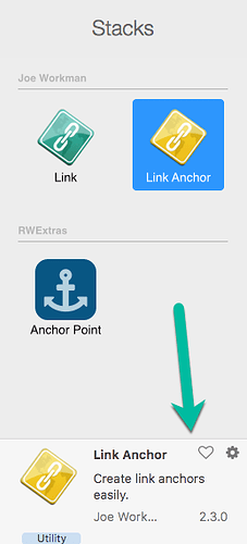

Make sure you are using the latest version of the Anchor link stack 2.3.0.
